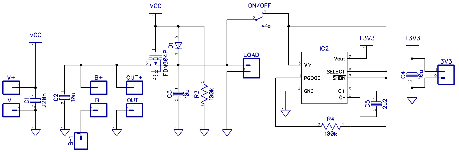

Load sharing means that you can power your circuit in two ways, from battery and from Vcc if a charger is connected. Once the charger is connected the battery will start charging and the load will be powered directly from Vcc. Robert added this feature to a recent design and also he added voltage regulation by using MCP1252.

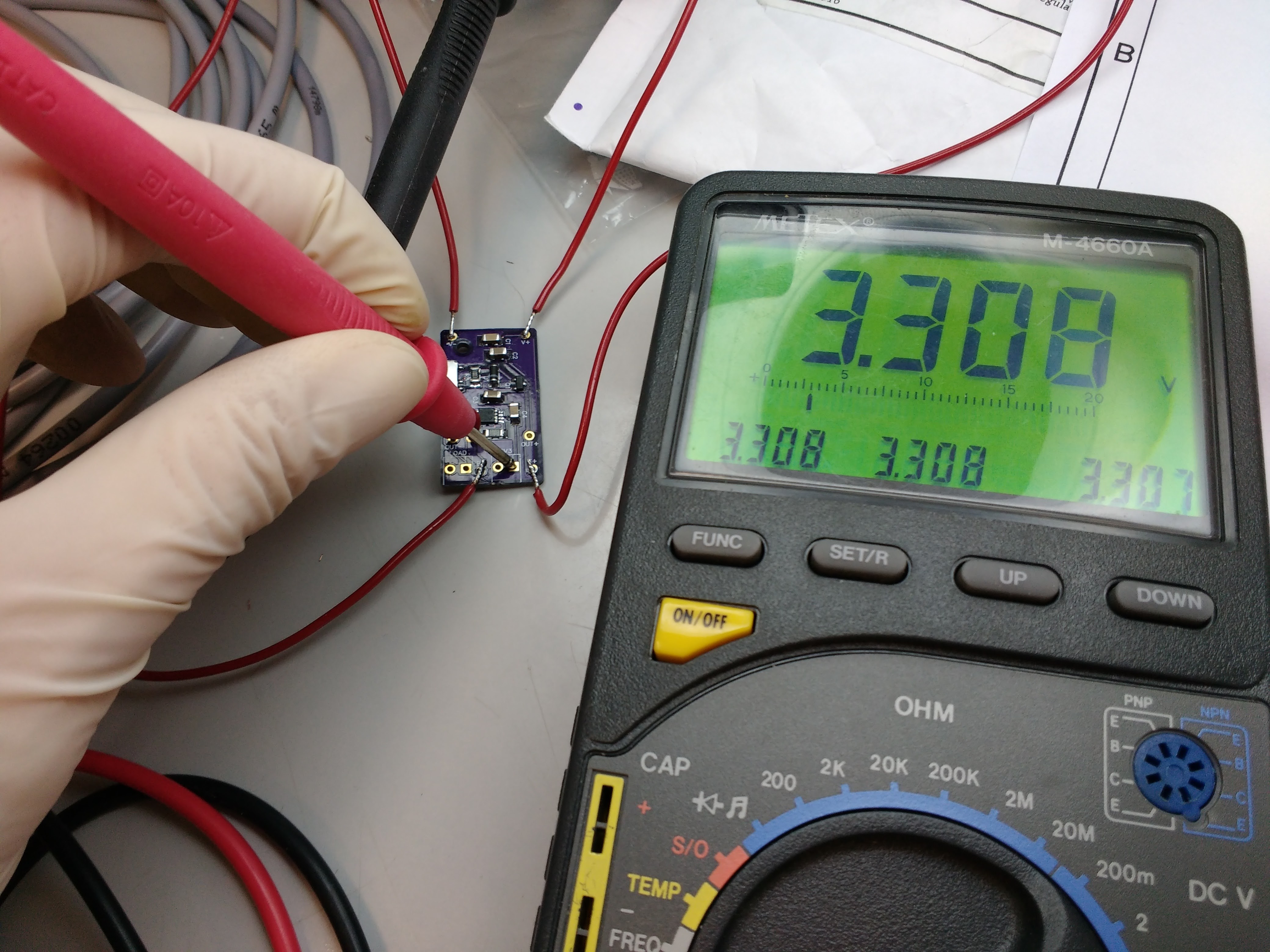

This schematic was inspired by multiple designs and modified by Robert.
“The advantage of MCP1252 is automatic buck/boost feature, it will maintain the regulated output voltage whether the input voltage is above or below the output voltage (2.1 to 5.0 V input range) so it is ideal for the lithium battery voltage. If you read the datasheet for the MCP1252-33X50I/MS there is clearly specified what type of MLCC capacitor should be used.”
The maximum output current of this board is 120mA and the output voltage is 3.3 V. It may sound not that suitable for your projects if you want to power an ESP8266, but still you can build your own board with different components to achieve the outputs you need. For example, by using MCP1253, which is identical to MCP1252, you will get  higher switching frequency (1MHz). Robert’s plan is to use this board with CO2 sensor (about 30 mA) and other low power sensors, some MCU and LCD, which can be powered using 120 mA.
