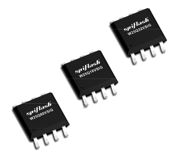

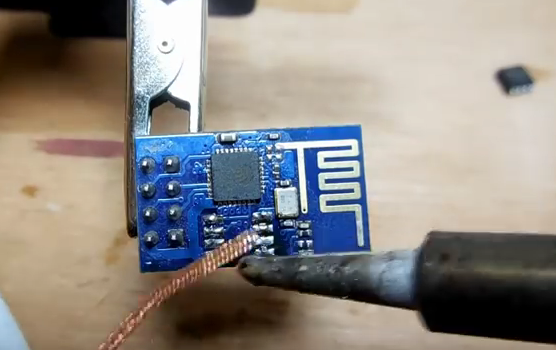

The SPI flash used in ESP8266 modules is W25qxx from Winbond, and in order to upgrade your flash memory you need to remove the old chip soldered to your module PCB and then solder the new one W25Q32 (32M-bit / 4M-byte), which can be ordered from Aliexpress.
w25qxxesp8266upgrade
[Code and Solder] channel over Youtube shared with us how to do the upgrade process.
https://www.youtube.com/watch?v=7Q6ABad7U6o &rel=0
