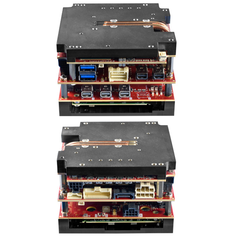

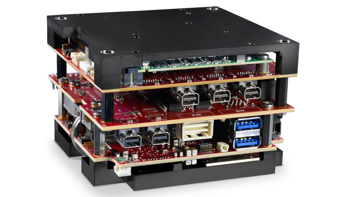

VersaLogic Corporation has recently showcased the Sabertooth AI, a rugged and compact GPU-enabled embedded computer designed for AI and 3D rendering in harsh environments.
Sabertooth Rugged AI
It is powered by an Intel Xeon-E hex-core processor and an NVIDIA RTX 2000 ADA GPU, supporting high-performance AI inferencing and CUDA programming. With industrial-grade durability, it operates between -40°C to +85°C and meets MIL-STD-202H for shock and vibration resistance. Key features include 32GB ECC RAM, 128GB NVMe SSD storage, multiple Mini DisplayPort++ outputs supporting up to 8K video, dual Gigabit Ethernet, and extensive industrial I/O options like USB, RS-232/422/485, and digital I/O. Industries widely use it in defence, aerospace, medical, smart security, and energy applications, and it is designed for long-term availability; it ensures reliability in mission-critical operations.

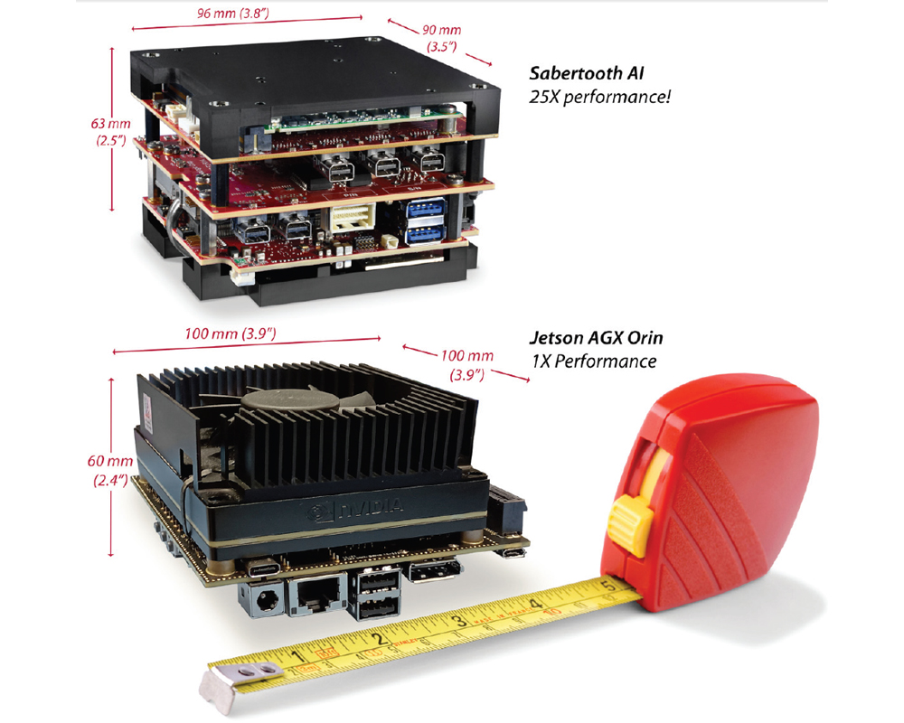

  • Dimensions: 90 x 96 x 63 mm
  • Weight: 680 grams (Heat plates included)
