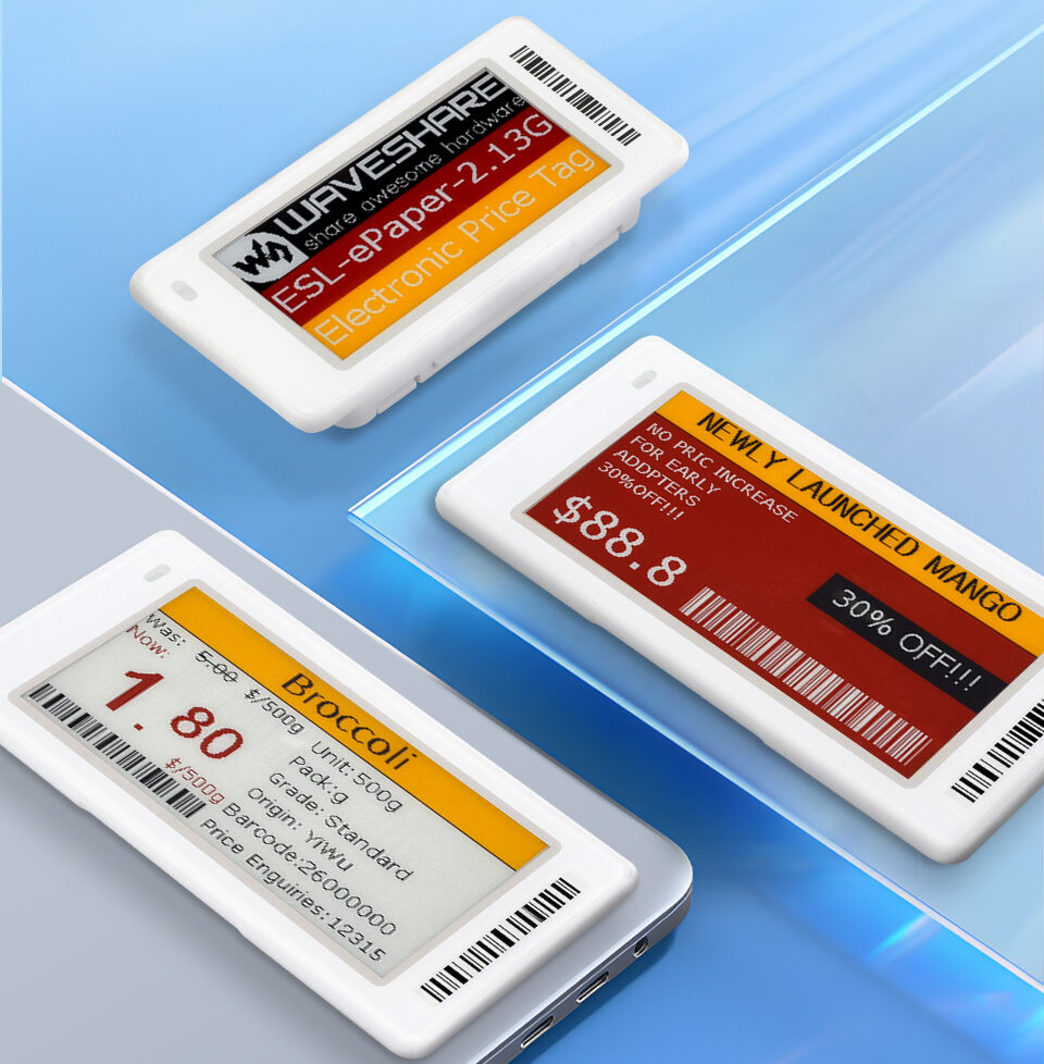

Waveshare has recently launched the ESL-ePaper-xxxx, a series of ESL e-Paper Displays featuring Bluetooth 5.1 and NFC connectivity, designed for IoT, retail, industrial, and similar applications.
These displays support four colors (red, yellow, black, and white) and are available in sizes ranging from 2.13″ to 3.5″, with resolutions up to 384 × 184 pixels. They operate on an ultra-low power design, using a built-in 1200mAh coin cell battery that can last up to five years. Additionally, the displays can be updated remotely via Bluetooth or locally through NFC, and they integrate with Waveshare’s cloud platform through a BLE base station, which connects via dual-band WiFi and is powered by a 48V PoE supply. Housed in a durable ABS plastic case with a 178° viewing angle, these displays are ideal for price tags, shelf labels, asset tracking, and conference name tags. However, their operating temperature range is limited to 0°C–40°C, and the 2.9″ model appears to use Bluetooth 5.0 instead of 5.1.

Waveshare  ESL e-Paper Displays Specifications
  • Display
    • Technology: E-Paper (Electrophoretic)
    • Colors: Red, Yellow, Black, White
    • Viewing Angle: 178°
    • Sizes & Resolutions:
      • 2.13″ – 250 × 122 pixels (130 DPI), 48.55 × 23.7mm display area
      • 2.66″ – 296 × 152 pixels (125 DPI), 60.09 × 30.7mm display area
      • 2.9″ – 296 × 128 pixels (112 DPI), 66.9 × 29.06mm display area
      • 3.5″ – 384 × 184 pixels (122 DPI), 79.68 × 38.18mm display area

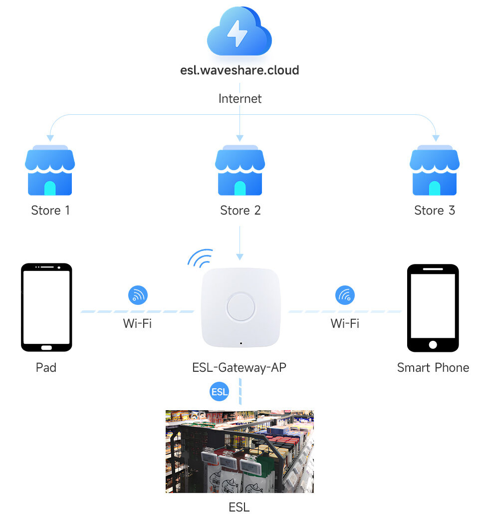

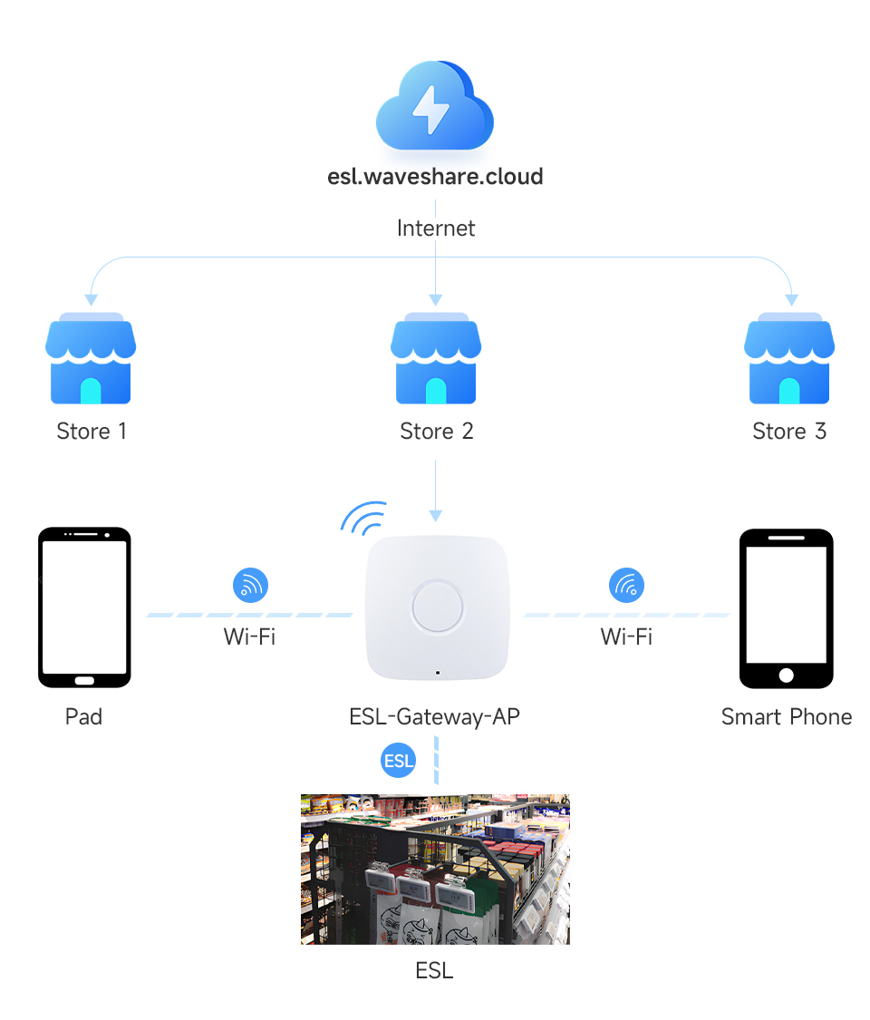

Waveshare's ESL e-Paper Displays base station.
The displays connect to a BLE base station, enabling control via the ESL Waveshare cloud platform. The station supports dual-band WiFi (2.4GHz/5GHz), 48V PoE, and speeds up to 1167 Mbps, with a 10–30m indoor range. It measures 180 × 180 × 33mm and operates from -10°C to 60°C.
ESL Gateway AP Specifications
  • Wireless: Dual-band WiFi 5 (2.4GHz & 5GHz)
  • Connectivity: Bluetooth LE for ESL updates
  • Power: 48V PoE
  • Data Speed: Up to 1167 Mbps
  • Range: 10–30 meters indoors
  • Operating Temperature: -10°C to 60°C
  • Dimensions: 180 × 180 × 33mm
