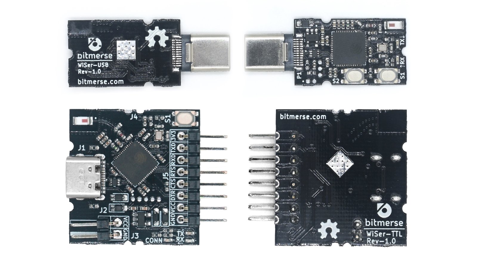

WiSer is a Wireless Serial Adapter for Cable-Free Data Transfer
WiSer is a USB-to-UART converter with a wireless twist. This pair of devices will let you establish a wireless serial connection between a host and a target device, which makes this ideal for remote monitoring, wireless data logging, telemetry, and various other applications.
WiSer enables wireless, peer-to-peer serial connections between devices, allowing for debugging, data logging, firmware updates, and file transfers without USB cables, Wi-Fi, or Bluetooth. It's simple and efficient, requiring no software, drivers, or setup. Just connect the USB module to your computer and the TTL module to your device, and use your serial monitor wirelessly.

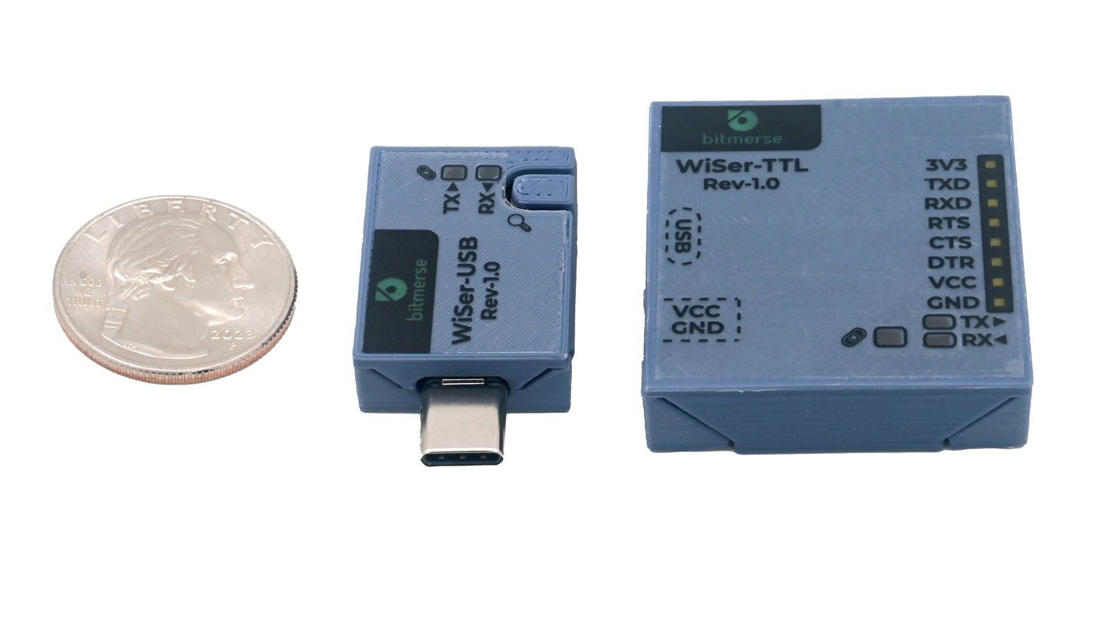

One key strength of the WiSer is that it simplifies connections by replacing USB cables, Wi-Fi, and Bluetooth setups. Just connect its USB module to a computer and a TTL module to the target device, without extra software or complex setup. It works like a virtual cable, making connections much easier.
WiSer offers two configurations, WiSer-USB and WiSer-TTL, both featuring an ESP32-S2 Wi-Fi SoC for strong connectivity. It supports various baud rates and data formats. For simplicity the device includes “FIND PAIR” and “BOOT” buttons. The compact design of both units is practical for use. Taking a look at operating systems this device is compatible with Windows, Linux, Mac, and Android, and works with serial terminal software like PuTTY and Tera Term, making it a versatile tool for diverse applications.

  • Dimensions: WiSer-USB: 37.8 x 20.4 x 8.2 mm; WiSer-TTL: 36.5 x 38.4 x 9.8 mm (smaller without enclosures).
