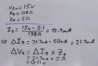

Then he demonstrated in numbers how the regulation output will change when we change Vin from 12V to 15V.
Zener_reg_v
Beside the problem of output voltage variation, we can see that the zener will consume about 70mA to regulate Vin to 5.1V which is a quite considerable amount of current. So using zener for main power regulation in your circuit is not advisable. You can use some well known voltage regulation ICs like LM7805, which have a stable output and a very low quiescent current.
Zener regulation feature still very useful for low power signals.
The high current needed for zener regulation operation will also produce a high power dissipation, P= U*I = 5.1 * 0.05 = 0.255 W which is a considerable power value.
