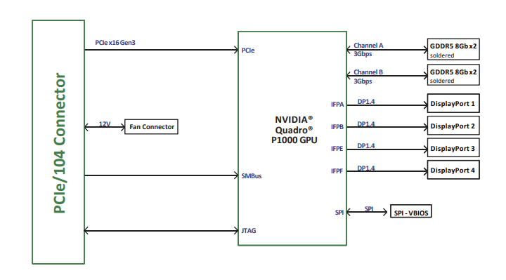

Discussing further, the module comes with four ultra-high definition (UHD) DisplayPort outputs as well as a PCIe Gen3 interface with a 16 lane configuration. Additionally, this board features 4GB of GDDR5 embedded memory with a 128-bit memory width. Moreover, it also offers 96GB/s maximum memory bandwidth. The module is compatible with both Windows 10 and 64-bit Linux operating systems.
Functional Diagram of CM5-P1000
