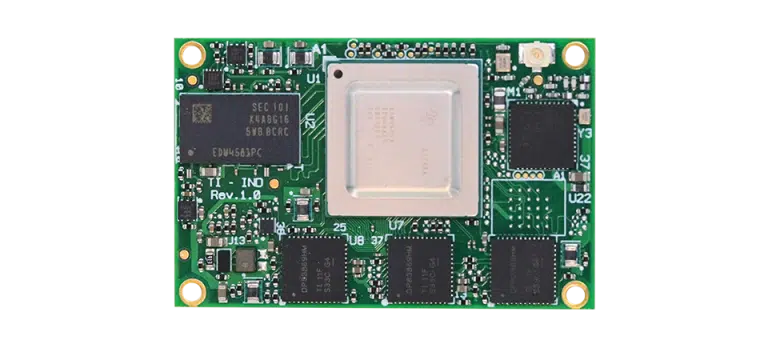

AM64 Sitara Series Dedicated to Edge Computing Devices for Industry 4.0
Edge computing remains advantageous in applications where real-time processing and proximity of the data with overall efficiency, over cloud computing. Considering the lack of options in the edge computing space, Texas Instruments have launched the 5 AM64 Sitara series of edge computing processors.
The AM64 Sitara series members are: AM6442, AM6441, AM6421, AM6412 and AM6411.
Integration of Dedicated Cores for Special Tasks
By taking advantage of the ARM architecture, the AM64 Sitara series integrates multiple processors which specialize in specific tasks solely edge computing work like real-time data handling, networking and on-the-go task optimization for various industrial applications. With high-level OS and service features handled by the Cortex A53 CPU cores, the Cortex R5F cores are dedicated to real-time computing of data. In this way, the operations of the processor are split into various processing nodes so they do not interrupt operations for completing tasks.

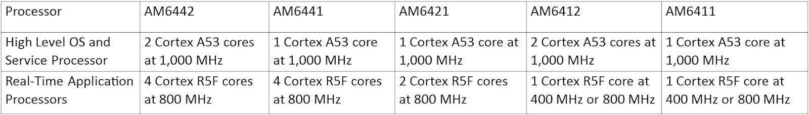

The processor specifications are as follows:AM64 Sitara Series Processor Specifications
Despite having few disparities in lower-end models, every processor is designed to be cost-effective as well as energy efficient with lower-end models requiring less power for conducting operations. These disparities prove indispensable when overall energy consumption and cost are prioritized over extra performance in applications.
