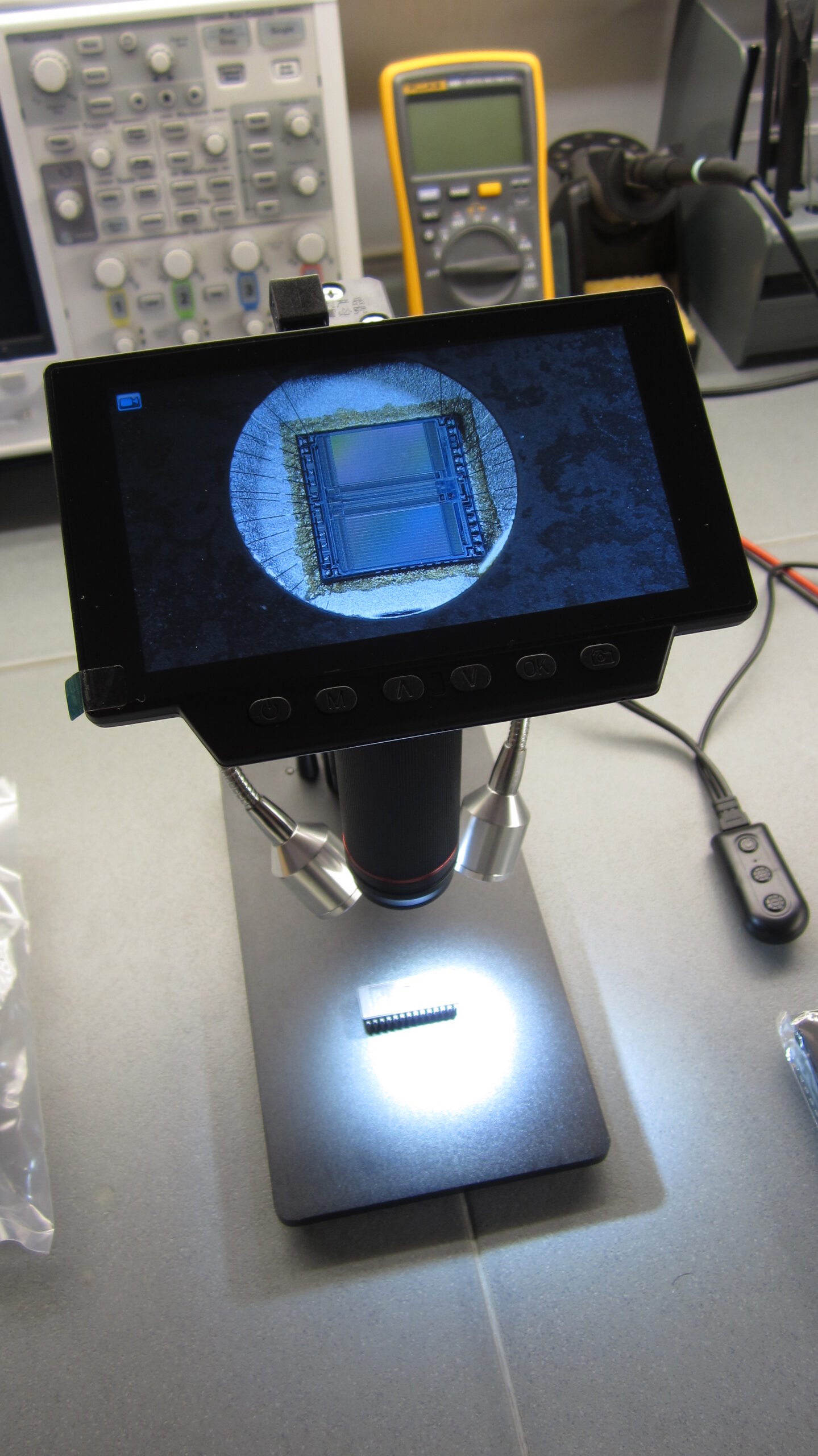

The first impression we had is that it is a well build and quality constructed microscope with precise movement of the focus and distance set knobs. The two LEDs add adequate light on the test bench and they are easily configured in both placement and light intensity.

Another area of improvement is the base, which is much larger and heavier than the previous model. This give the device more stability. The objective table is big enough to do most of the soldering and repair work. One area of improvement i like is the black color, which is different from the reflective silver of the older model. This is a significant improvement, because the silver color made it hard to look at single components without glare. The Andonstar microscope is fully functional even without using it’s software or connection to a PC or TV screen.

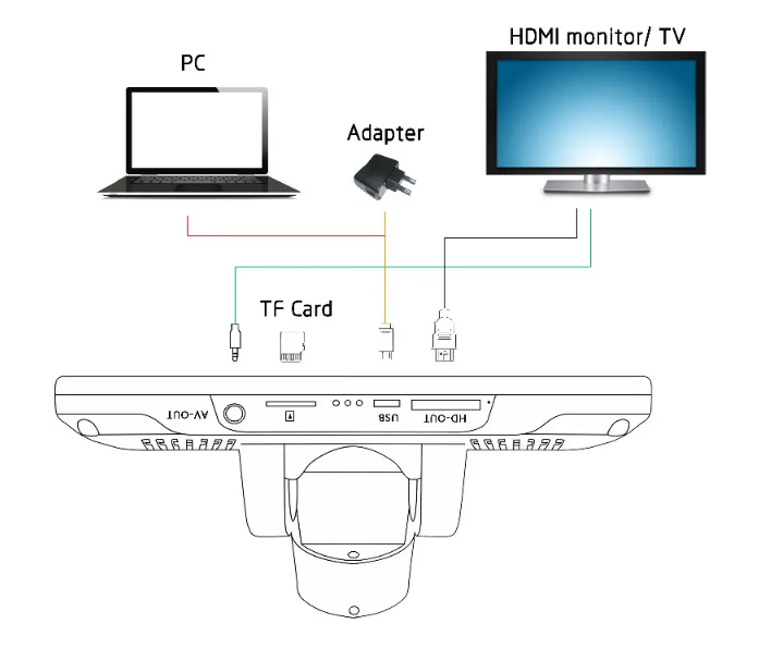

The ADSM302 can support 4 different outputs, not including its own monitor: AV-OUT, USB, HD-OUT and SD memory card. It also features buttons & IR remote, which is handy when a user is doing some repair work on the table, it would be convenient for them to capture photos, record videos, zoom in and out etc from a distance.
If you want to perform object or specimen manipulation under the viewing lens barrel, you have a maximum working distance of slightly more than 4.5 inch. This should be sufficient space to perform any sort of SMD related works. The ADSM302 features two adjustable LED illumination arms shining down both sides of your viewing object or specimen. This gives the user a very clear and concise viewing experience.

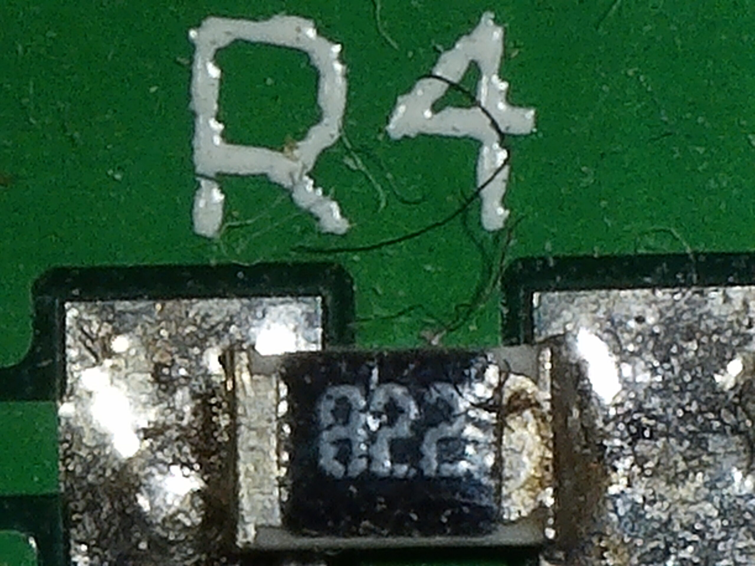

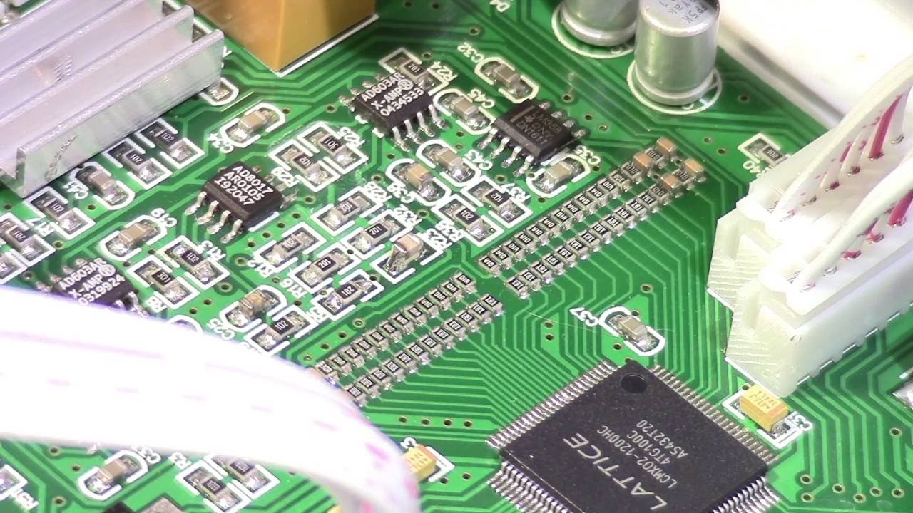

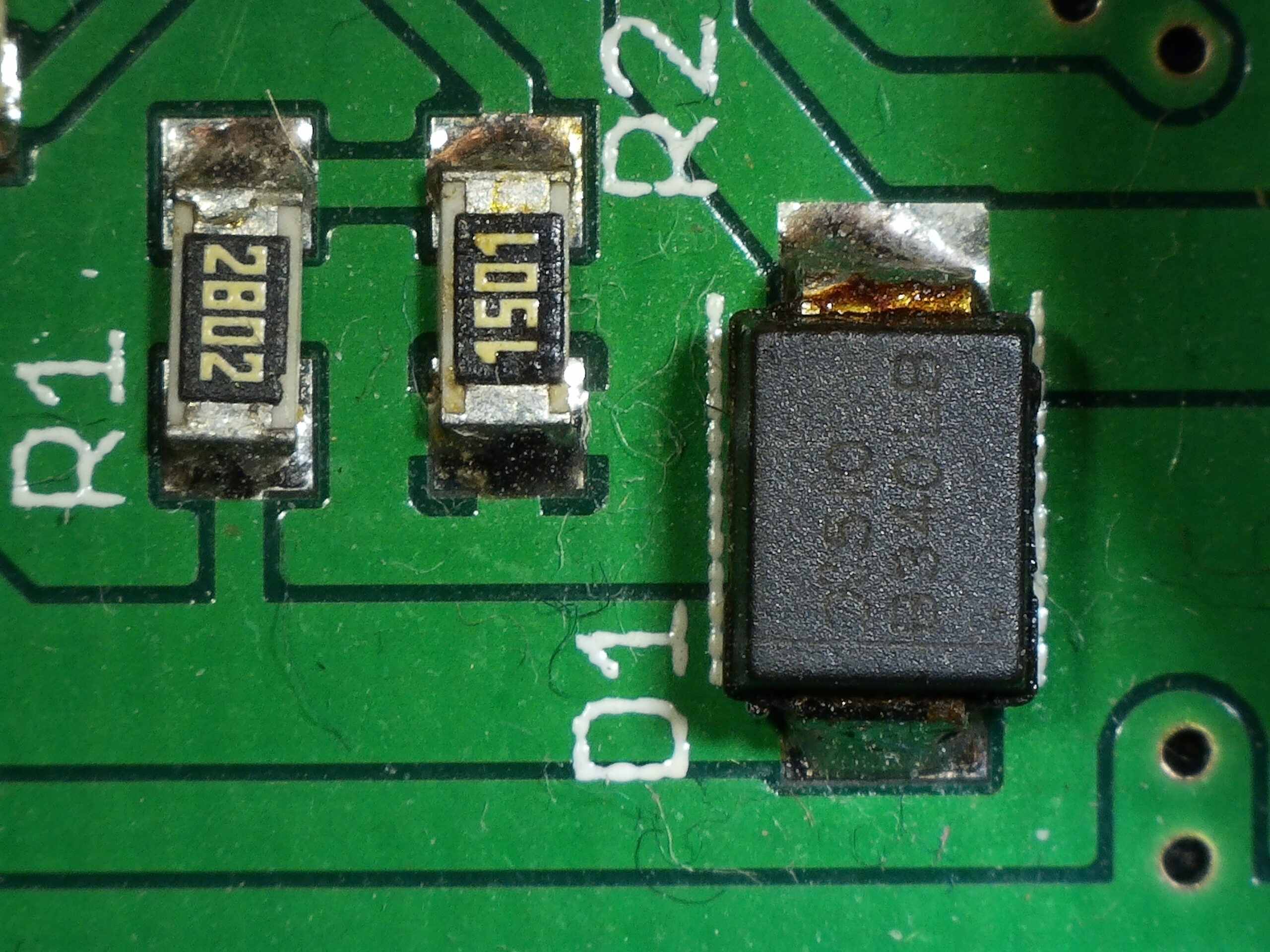

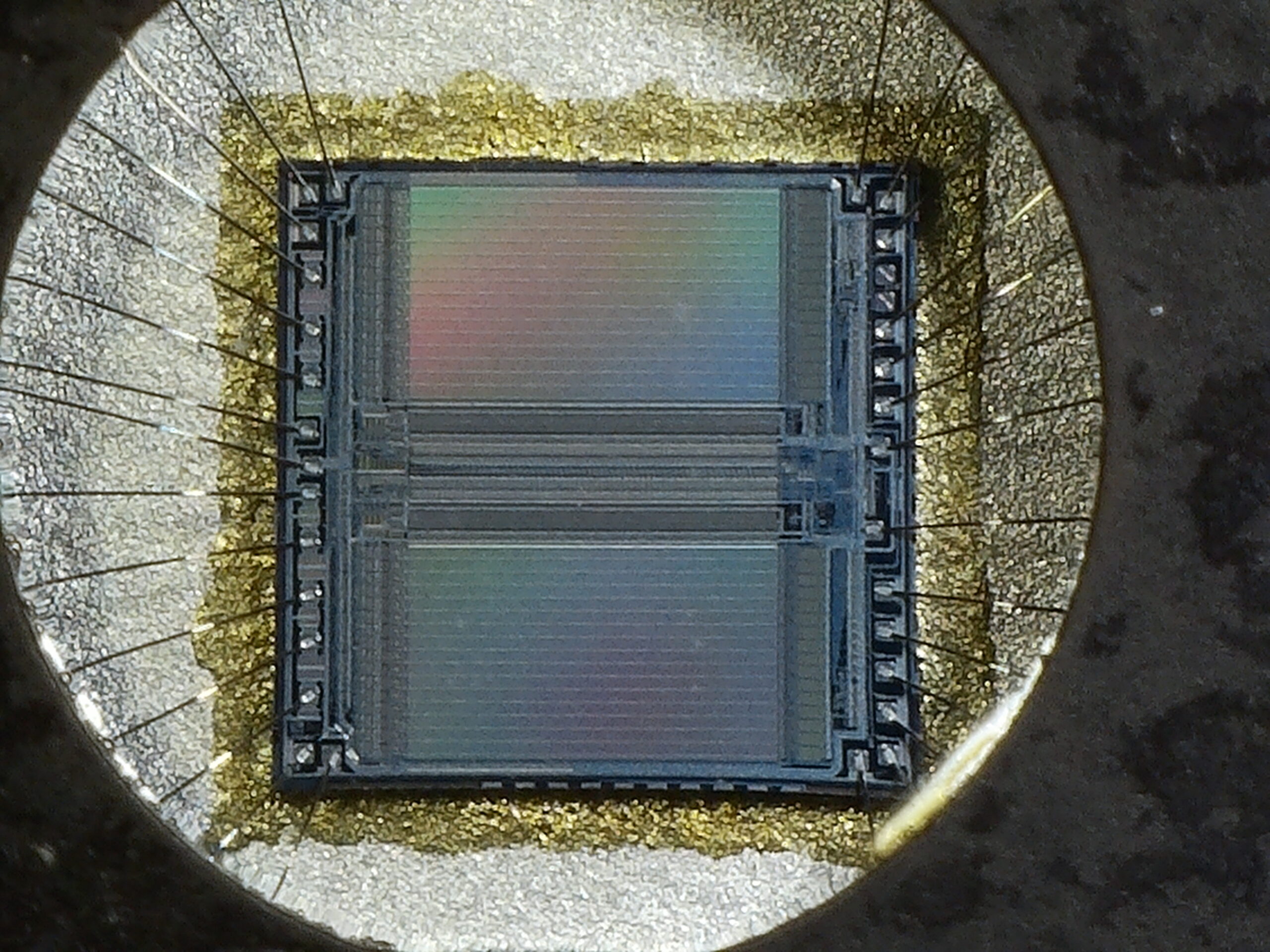

Here are some images captured on the SD card of the microscope. As you can see the quality is nice and the images are sharp and clear. Resolution of images is 4032 x 3024 px which is fair enough.
ADS
