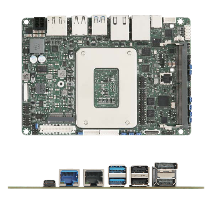

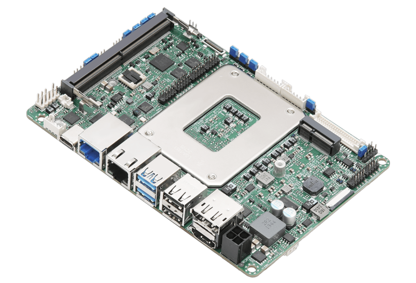

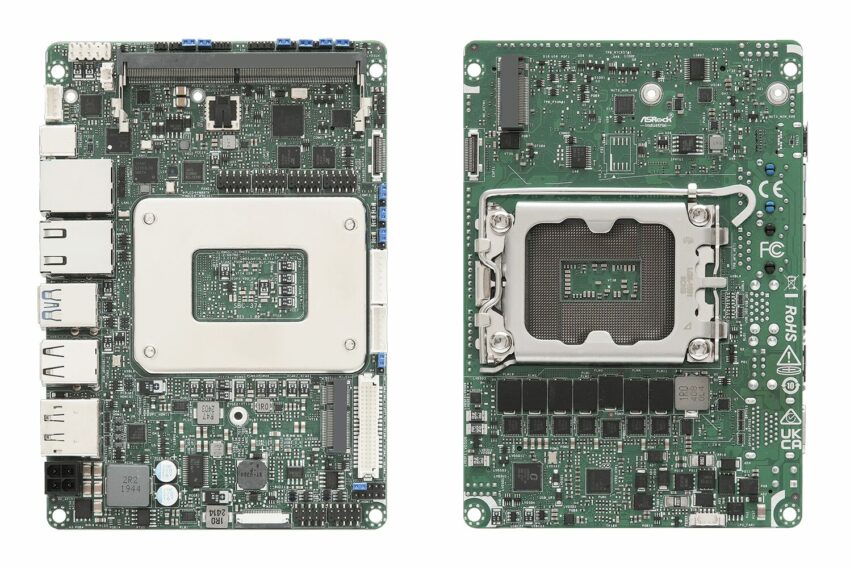

The ASRock Industrial SBC-374 is a powerful 3.5-inch motherboard designed for embedded applications. It is equipped with an Intel Core Ultra Meteor Lake-PS processor on an LGA 1851 socket, supported by an AMI SPI BIOS with secure flash capabilities for enhanced security in demanding environments. The board includes a 262-pin SO-DIMM slot, supporting DDR5 memory up to 48GB at 5600 MHz, making it ideal for high-performance tasks.
The device is powered by Intel Xe LPG Graphics, supporting quad-display configurations through an HDMI 2.1 TMDS port and two DisplayPort 1.4a outputs (one via Type-C), all capable of resolutions up to 4096 x 2160 at 60Hz. A shared connector for LVDS and eDP provides additional flexibility, supporting up to 1920 x 1200 at 60Hz for LVDS and 1920 x 1080 at 60Hz for eDP. The SBC-374 also offers extensive connectivity options, including USB 3.2 Gen 2 Type-C, multiple USB 3.2 and USB 2.0 ports, along with two COM (RS-232/422/485) ports for serial communication.
ASRock SBC-374 3.5-inch Motherboard specification:
  • SoC: Intel Core Ultra Meteor Lake-PS processor up to 45W
    • BIOS: 256 Mbit AMI SPI
    • Optional 32 Mbit AMI SPI secure flash
  • Graphics: Intel Xe LPG Graphics
  • Memory: Up to 48GB single-channel DDR5 5600 MHz, 262-pin SO-DIMM socket
  • Storage:
    • 1x M.2 (Key M, 2242/2280) with PCIe Gen4 x4 for SSD
    • 1x SATA3 up to 6Gb/s
  • Display:
    • 1x HDMI 2.1 TMDS with maximum resolution up to 4096 x 2160@60Hz
    • DisplayPort 1.4a, DP++ with maximum resolution up to 4096 x 2160@60Hz
    • 1x Dual channel 24-bit LVDS up to 1920 x 1200@60Hz (Connector shared with eDP)
    • 1x eDP port with Max resolution up to 1920 x 1080@60Hz (Connector shared with LVDS)
    • Quad display support (Included 1 output from Type-C, HDMI + DP + LVDS/eDP + Type-C)
  • Audio:
    • Realtek ALC256 HD for high-definition audio
    • 1x internal speaker header
  • Networking: Intel I226V and Intel I219LM  controller
    • 1x 2.5GbE LAN port
    • 1x GbE LAN port
    • Optional WiFi, Bluetooth via M.2 sockets (see Expansion section)
  • USB:
    • 1x Type-C port for power and DP 1.4a display output
    • 2 x USB 2.0
    • 1x USB 3.2 Gen 2
    • 4 x USB 2.0 internal header
  • Serial: 2x COM port supports RS-232/422/485
  • Expansion:
    • 1 x M.2 (Key E, 2230) with PCIe Gen4 x1 and USB 2.0 for Wireless connection
    • 4 x GPI and 4 x GPO header
  • Security: TPM 2.0 onboard IC
  • Misc:
    • Watchdog timer
    • 1x MIPI camera header
  • Power:
    • 2~28V DC-In with 4-pin wafer PWR
    • AT/ATX Supported
      •  AT: Directly PWR on as power input ready
      • ATX: Press button to PWR after the power input ready
  • Dimension: 14.7 cm x 10.2 cm x 2.77 cm
  • Temperature range:
    • Operating: -20ºC ~ 70ºC
    • Storage: -40°C ~ 85°C
  • Humidity:
    • Operating: 5% ~ 90%
    • Storage: 5% ~ 90%
The SBC-374 integrates a TPM 2.0 onboard IC and supports Intel vPro technology, offering secure hardware-based data protection and management. It operates on a 12–28V DC input with a power configuration that supports both AT and ATX modes, ensuring adaptability across diverse power environments. Previously, we covered other 3.5-inch motherboards, including the ECM-EHL, IBASE IB919, Vecow EMBC-3000, and Jetway F35-ADN1. Feel free to explore these products if you’re interested.
