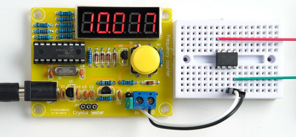

To test it I toggled an output at the clock frequency, and measured it with a frequency meter
The reading of 10MHz implies a clock frequency of 20MHz.
