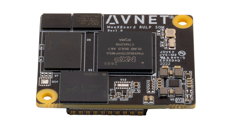

Avnet MaaXBoard 8ULP moduleThe hardware platform is manufactured as two PCBs– a system-on-module as shown in the figure above is connected to a baseboard through 2x 100-pin connectors to support a rich set of input/output interfaces. Some of these interfaces include a Gigabit Ethernet, two USB 2.0 host interfaces, a Raspberry Pi HAT compatibility through 40-pin header, and a Mikroe Click 16-pin header.
