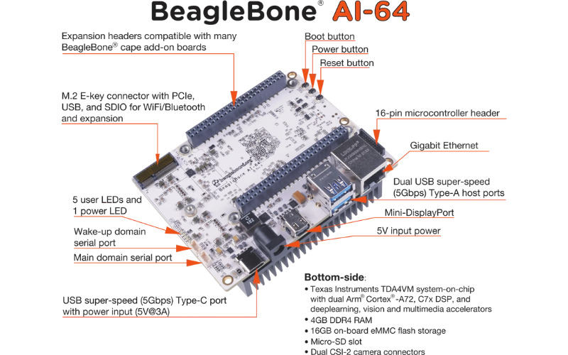

Specifications of BeagleBone AI-64 single-board computer:
  • SoC: Texas Instruments’ Jacinto TDA4VM system-on-chip with 2x Arm Cortex-A72 processor core clocked at a frequency of 2GHz
  • GPU: 3D GPU PowerVR Rogue 8XE GE8430 up to 750MHz, 96GFLOPS, and 6Gpix/sec
  • Memory: 4GB LPDDR4 RAM
  • Storage: 16GB eMMC flash storage with microSD card slot for expansion
  • Onboard modules: On-die processor temperature sensor
  • Interfaces: M.2 e-key PCIe connector to interface Wi-Fi and Bluetooth modules, USB 3.0 Type-C interface for power, 2x USB 3.0 Type-A interface, Gigabit Ethernet
  • Display: 4-lane DSI connector for display options
  • Camera: 2x 4-lane CSI connector for camera modules
  • Serial communication: 2x I2C, 2x SPI, 4x UART
  • Buttons: 1x boot button, 1x reset button, 1x power button
  • Power: USB Type-C port for power
  • LEDs: 1x power indication, 5x user LEDs
  • Software: Zero-download out-of-box software experience with Debian GNU/Linux
BeagleBone AI-64 Specs
