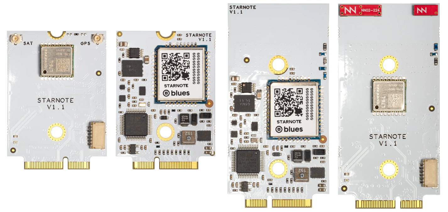

Blues and Skylo Technologies have partnered to create the Starnote Satellite IIoT module, a backup module that costs only $49. It's a backup module meaning it will connect to a satellite connection when cellular or Wi-Fi isn’t available.
Blues & Skylo's Starnote Satellite IIoT module offers backup for $49, with two versions, a PCB antenna or u.FL connectors, and 18KB free data.
Blues and Skylo Technologies have partnered to create the Starnote Satellite IIoT module, a backup module that costs only $49. It’s a backup module meaning it will connect to a satellite connection when cellular or Wi-Fi isn’t available.
The module is built in an M.2 E-Key edge connector from Factor and features a six-pin JST connector (on the backside of the PCB) for easy setup, the module has two versions one has a PCB antenna and another one has a u.FL connectors.
That’s not all Skylo is also providing 18KB of free satellite data without any monthly charges, and according to Blues, this 18KB will last a year if the module is sending a max of 50-byte of data every day.
The Starnote module comes in two variants: one with built-in satellite and GPS antennas for immediate use, and a smaller version for external antennas using u.FL connectors. It uses Skylo Satellite Coverage and supports 3GPP Rel-17. Detailed technical information, including processor specifications and comprehensive software/hardware support details, is not readily available, although a general API reference is provided by the company.

  • Satellite and GPS Integration:
    • Integrated satellite and GPS antennas for direct connectivity.
    • External antenna compatibility facilitated through u.FL connectors.
  • Connectivity Options:
    • JSON API support for integration with Notecard.
    • M.2 Key E and six-pin JST connectors offer versatile connection possibilities.
  • NTN Modem Features:
    • Equipped with an NTN (Non-Terrestrial Networks) modem.
    • Features zero-touch setup for ease of use.
  • Data Inclusion:
    • Comes with 18KB of Skylo satellite data.
    • No additional fees or subscriptions are required for the included data.
  • Antenna Variations:
    • Two variants are available: one with onboard satellite and GPS ceramic antennas, and another with external antenna capabilities via u.FL connectors.
  • Coverage and Support:
    • Utilizes Skylo Satellite Coverage.
    • Supports 3GPP Rel-17 connectivity.
  • API and Software Support:
    • Availability of API reference for software integration.
    • Lacks specific module information in the existing API reference.
  • Notecarrier Compatibility:
    • Compatible with Notecarrier A, B, F, and Pi Hat Boards.
    • Supports various Notecard modules including Cellular, Cell+Wifi, LoRa, and Starnote models with M.2 E-Key.
The Notecarrier series includes four types of boards: Notecarrier A, B, F, and Pi Hat. Each is compatible with Notecard modules including Cellular, Cell+Wifi, LoRa, and Starnote, as they all support the M.2 E-Key interface.
