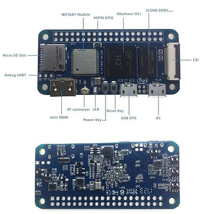

The BPi M2 Zero features Allwinner H2+ quad-core processor with 512MB SDRAM memory. The board size is only 60mm x 30mm, the same size of Raspberry Pi Zero W and also has the same interfaces.
BPi M2 Zero
M2 Zero design makes it ideal for light-weight systems with some space-limited applications. Like other members of Banana Pi, it supports both Linux and Android operating systems.
WiFi and Bluetooth LE are supported by the AMPAK AP6212 module. An IPEX connector will allow you to install an external antenna to improve reception, increase range or install in a metal box. And there is no clarification if the antenna is shared with Bluetooth.

  • CPU: quad-core cortex -A7 H2+CPU quad-core cortex -A7 H2+
  • GPU: Mali-400 MP2
  • Memory: 512MB DDR3 SDRAM (shared with GPU)
  • Storage support: MicroSD Card(up to 64GB)
  • WiFi: 802.11 b/g/n (AP6212)
  • Bluetooth: BT4.0 (AP6212)
  • Video In: CSI connector that supports 8-bit YUV422 CMOS sensor CSI, CCIR656 protocol for NTSC and PAL, 5MP camera, 1080p video @30Hz
  • Video Out: Mini HDMI
  • Power Source: 5V 2A Micro USB
  • USB Ports: USB OTG(Micro USB)
  • Buttons: 2GPIO 40 Pins
  • OS support: Android and Linux etc.OS
  • Dimensions: 60mm x 30mm
  • Weight: 35g
BPi Zero Interface
The Banana Pi M2 Zero is available now on the AliExpress website at a price of $13 without shipping. Till now, only Ubuntu 16.04 and Arabian images are available on the download page. And also the documentation and drivers are not ready yet.
