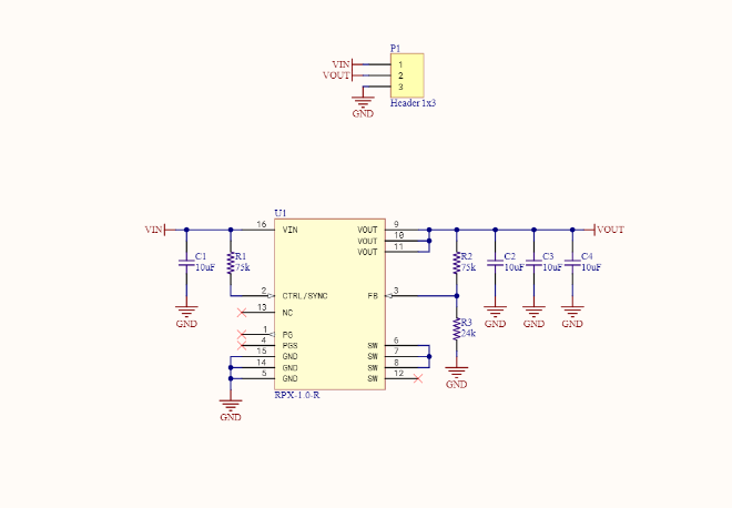

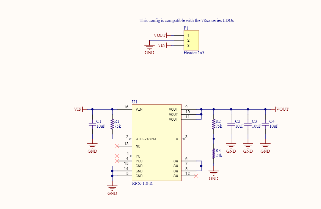

Ketan Desai, a student at the University of British Columbia designed a buck converter PCB which can be used in replacement of 78xx and LM1117 voltage regulators. It is built around a very compact RPX-1.0 DC-DC converter IC which comes with an integrated inductor. The 78xx compatible version is as follows:
Source: https://github.com/ketszim97/TO_220_Buck/blob/78xx/TO_220_Buck.pdf
Below is the LM1117 compatible version. The only difference is in the pinout.
Source: https://github.com/ketszim97/TO_220_Buck/blob/LM1117/TO_220_Buck.pdf
Both the above designs are configured for 3.3V. Replacing R3 will allow the output voltage to be set.
Output Voltage R3 Value
1.5V 86k6
1.8V 60k4
2.5V 35k7
3.3V 24k3
5.0V 14k3
12V 5k36
24V 2k61
