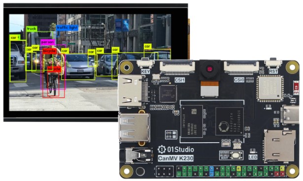

The 01Studio CanMV K230 AI development board, distributed by Youyeetoo, is built around Canaan Technology’s K230 AI chip. The K230 is a 64-bit dual-core RISC-V processor operating at 1.6GHz and 800MHz, equipped with hardware floating-point support and a convolution accelerator. It integrates a neural network processing unit capable of delivering 6 TOPS, making it suitable for AI workloads such as deep learning and neural networks.
This board is part of the CanMV open-source project, maintained by Canaan, which ports MicroPython to the K230 chip. The project focuses on creating a scalable and cost-effective AI module driven by Python, targeting edge computing applications. The CanMV K230 development board simplifies AI project development, offering efficient hardware acceleration for AI tasks.

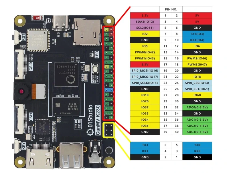

  • Expansion Ports:
    • 40-pin GPIO header (Raspberry Pi-compatible)
    • 1x XH-1.25mm-4P UART/I2C
    • 4x ADC, 4x PWM, 5x SPI
  • Miscellaneous:
    • 1x programmable key, 1x reset key
    • 1x programmable LED, 1x power LED
    • 3.3V, 5V, and GND pins

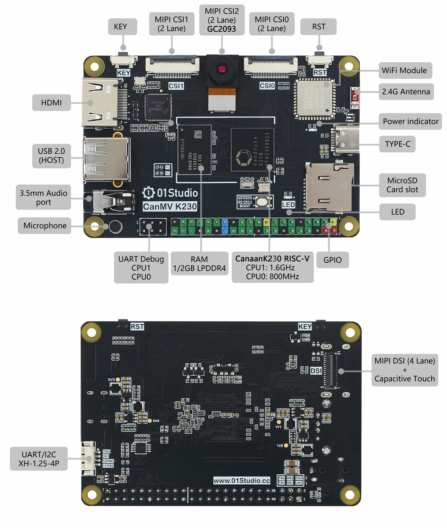

01Studio CanMV K230 AI development board specifications
The 01Studio CanMV K230 AI development board features the Kendryte K230 SoC, a dual-core RISC-V processor, with 1GB LPDDR4 memory and expandable storage via a MicroSD card (up to 512GB). It supports GC2093 and OV5647 cameras, with MIPI-CSI interfaces, and offers display options through MIPI DSI and HDMI (up to 1920×1080).
The board’s KPU supports INT8 and INT16 data types, enabling AI models like ResNet50, MobileNet v2, and YOLO V5s. Connectivity includes 2.4GHz Wi-Fi and optional Ethernet, with audio input/output via a microphone and 3.5mm jack. It offers hardware integration through GPIO, UART, I2C, and SPI. Designed for use with Python or MicroPython, the board supports AI applications such as object counting, barcode recognition, and face detection.
01Studio CanMV K230 AI development board pinout
