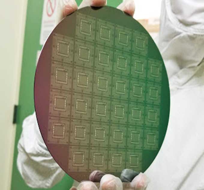

However, until now, they have proved too difficult to use in constructing a complex computing system but the team of researchers led by Professor Max Shulaker has successfully built a chip using them and the chip was tested by running a simple program “Hello World!”. The developed chip is the most complex integration of Carbon nanotube-based CMOS logic so far with nearly 15,000 transistors.
While the milestone is a great one, there are a few issues encountered by the researchers. One of the issues is the Carbon nanotube purity, with each batch of semiconducting carbon nanotube, containing 0.01 percent of metallic nanotube which is undesirable as they act as wires and they can short out the circuit, waste power and/or produce noisy signals. To solve this,  Shulaker and colleagues came up with a solution to design a separate circuit with a good combination of logic gates and avoid using the bad combination that was most confused by the metallic nanotube glitches.
Another problem the team faced was the uniformity of the carbon nanotubes, the tubes tend to bunch together in lumps when a network of carbon nanotubes is deposited onto a computer chip wafer and this prevents the transistor from working. This problem was solved by Shulaker’s team by first coating the nanotube covered substance with photoresist and then carefully washing it under just the right conditions. The process selectively removes the bundles but leaves the individual Carbon nanotubes.
After overcoming all of this hurdles, the team was able to create two types of transistors that are needed for the CMOS logic, these transistors are the kinds which are in use in all kinds of processors for decades and this was a big breakthrough called MIXED.
