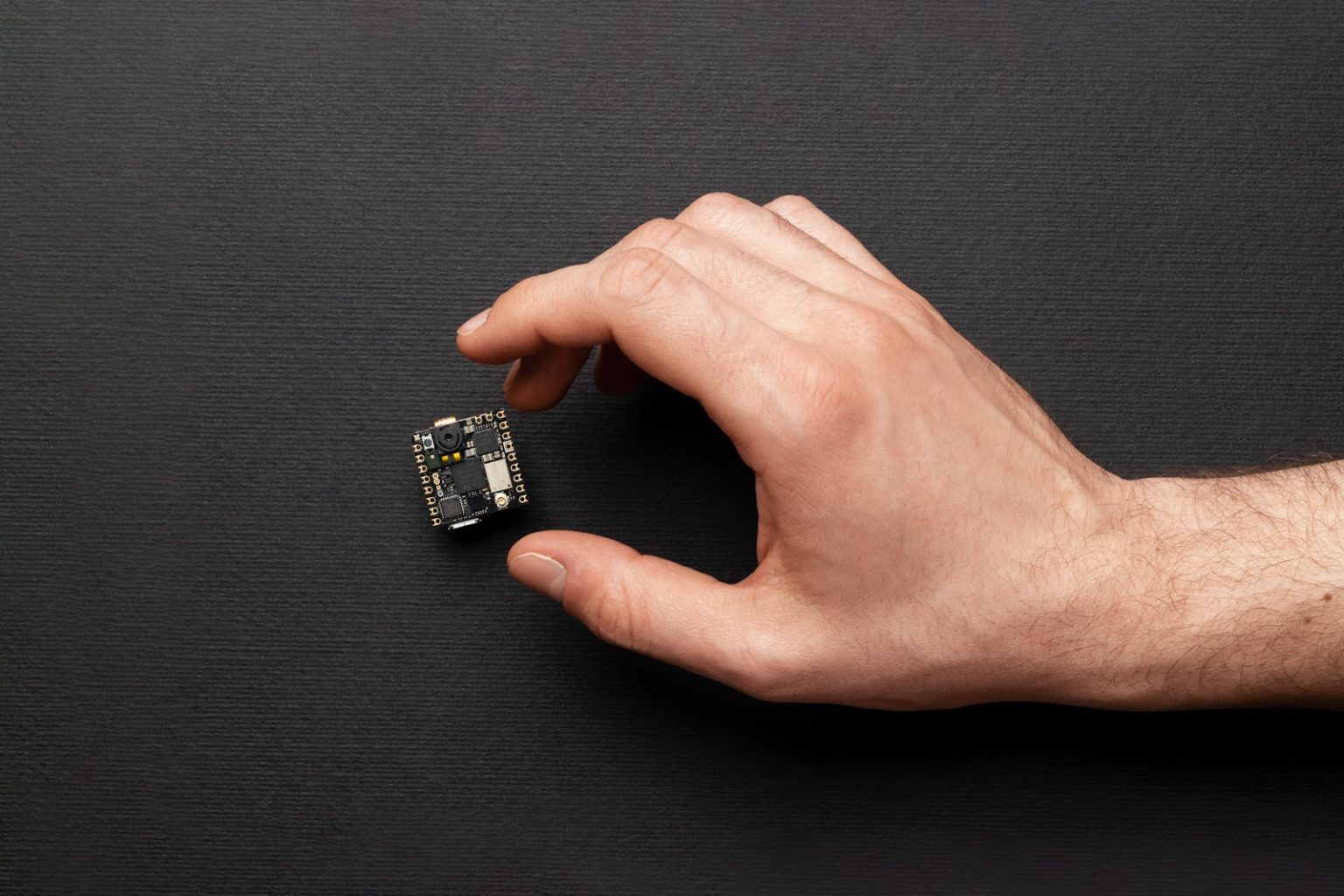

MCCI Corporation a USB System expert who has also been venturing in the line of IoT solutions has recently tipped a Catena 4710 FPGA board which is a “feather-compatible FPGA board” that can easily fit into your pocket and comes with a RISC-V Core with support for Lora Networks.

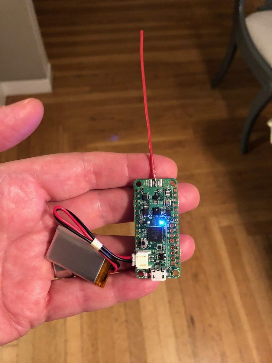

A 35 mm whip antenna and a 350mAh LiPo battery attached to the MCCI Catena 4710
The device is also sensor ready; it comes with an environment sensor –  the BME280 sensor which enables to sense temperature, pressure, and humidity. Also, it has a light sensor, a color sensor, an accelerometer, and a possible microphone unit. There’s also an antenna connector at one end, as well as a USB and battery jack for charging and plugging Li-Ion batteries.
