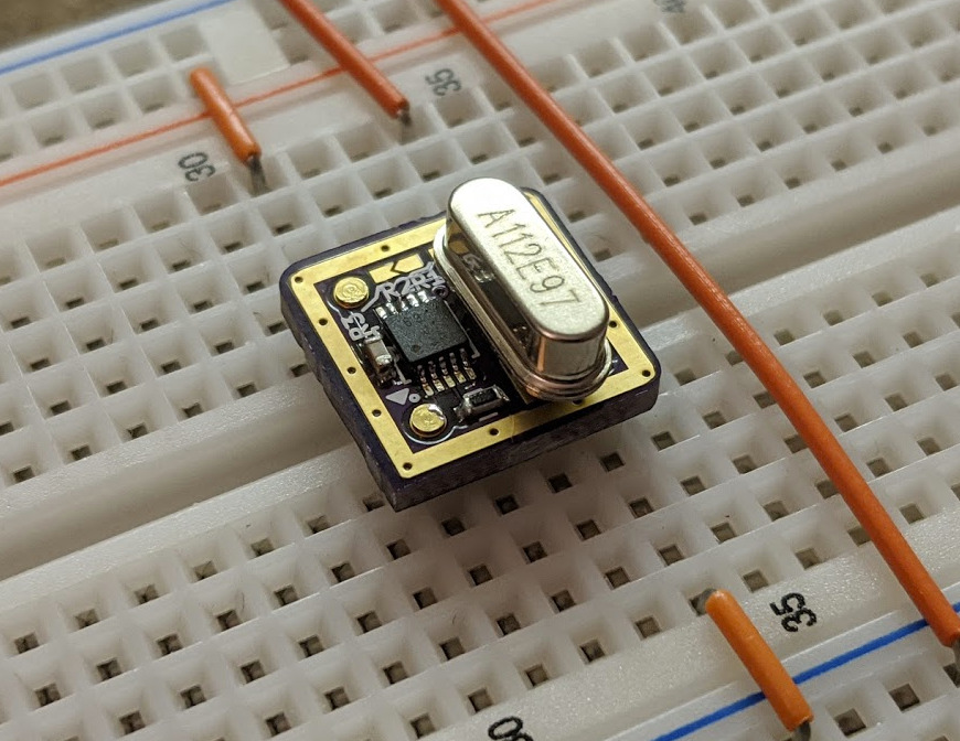

Most microcontroller implementation these days, use the traditional capacitor + crystal approach to generate their clock, this approach sometimes, however, lead to problems, especially when used in prototyping situations with a breadboard, jumper wires, etc., all of which have an (unknown) inherent capacitance that could lead to the clean 8 or 16MHz signal we desire, becoming noisy. A (now regarded as old school) approach to eliminating this is to use a full-can or half-can oscillator which usually comprises the crystal and other elements of the oscillator circuits.
Most microcontroller implementation these days, use the traditional capacitor + crystal approach to generate their clock, this approach sometimes, however, lead to problems, especially when used in prototyping situations with a breadboard, jumper wires, etc., all of which have an (unknown) inherent capacitance that could lead to the clean 8 or 16MHz signal we desire, becoming noisy. A (now regarded as old school) approach to eliminating this is to use a full-can or half-can oscillator which usually comprises the crystal and other elements of the oscillator circuits. However, with advances in microcontroller technologies relegating the need for these oscillators, manufacturers are discontinuing legacy product lines and it’s becoming harder and harder to find through-hole versions of the full/half can packages.  To give the OG’s another option, Schlae recently developed a breadboard friendly PCB version of the full-can and half-can oscillator package called ClockInACan.
According to Schlae, the ClockInACan is a small circuit board that comes in the form factor of the full-can and half-can oscillators and performs the same exact function as the oscillators.

The oscillators are super easy to use, and all you have to do is provide your own crystal of the desired frequency or a multiple of the desired frequency, and set the three solder jumpers to select the divide ratio.
To make the project easy to replicate, it is designed with readily available components. The basic bill of materials is provided in the table below and all components can be found on Mouser by searching with the Mouser Part Number.
