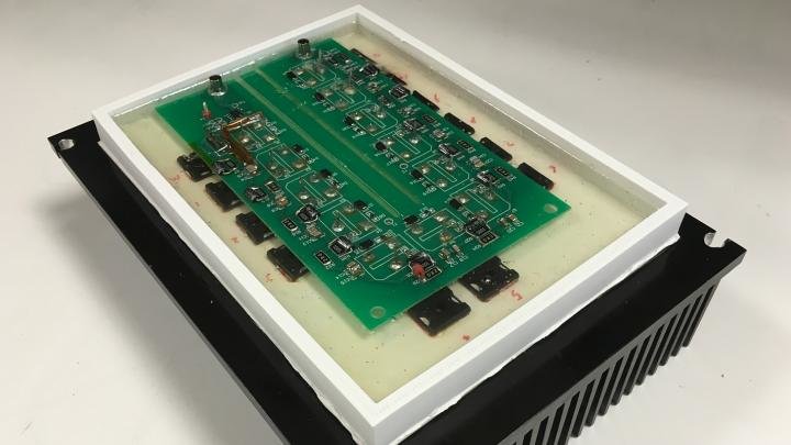

The new SiC power switch, called FREEDM Super-Cascode Switch, contains a series of 1.2kV SiC power devices to produce a 15 kV and 40 mA output that can transcend the 15 kV SiC MOSFET in ease of adoption and cost – since it costs only one third of the estimated high voltage SiC MOSFETs. In addition, this new switch is capable of operating in a wide range of temperatures and frequencies due to its proficiency in heat dissipation, which is considered an advantage in power devices.
FREEDM Super-Cascode SiC Switch
Since there is no high voltage SiC device commercially available at voltage higher than 1.7 kV, as Alex Huang said – Progress Energy Distinguished Professor, he assures that this solution paves the way for power switches to be developed in large quantities with breakdown voltages from 2.4 kV to 15 kV.
