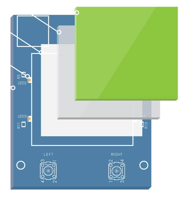

A custom made backlight were designed to allow using the Dintervalometer in the dark without an additional lamp. It operates like a backlight of a cell phone: it is active for 10 seconds when the user presses a button or the Dintervalometer finishes some job.
The backlight consists of these materials:
  • A sheet of white paper
  • A piece of transparent plastic
  • A double-sided tape
The first layer of the backlight is a sheet of white paper. Its main function is to reflect the light of the LEDs. Then it comes the piece of transparent plastic. The top of the plastic is sanded with a fine sandpaper to diffuse the light. Finally, the LCD comes on the top. The layers are glued together with a double-sided tape.

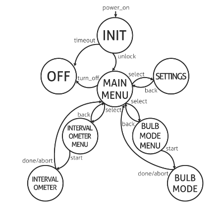

  • STATE: The state machine is implemented by using function pointers. Each menu state has three basic operations; show data on LCD, wait for user input, update backlight and battery status, and handle button presses/holds.
State Machine Diagram
