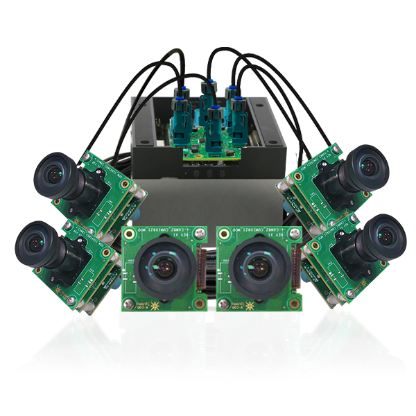

NileCAM81_CUOAGX is based on the half-inch AR0821 sensor from onsemi. It comes with a pixel size of 2.1µm x 2.1µm, thereby offering high sensitivity. This in combination with its high resolution of 4K helps to capture images with great details even in extremely low lighting conditions.
NileCAM81_CUOAGX is also an HDR camera that uses multiple exposures in a single frame to bring out details in the brightest as well as darkest areas of the same scene in high-contrast lighting conditions.
Further, NileCAM81_CUOAGX is a multi-camera solution. Hence, it has multiple camera pipelines that transfer high-resolution images and videos. Owing to this, it is designed to be compatible with high-performance host platforms like NVIDIA Jetson AGX Orin™ and NVIDIA Jetson AGX Xavier™.
With these features, this 4K multi-camera solution is suitable for applications such as Surround-view systems, autonomous mobile robots, smart trolleys, smart checkout systems, smart traffic management, sports broadcasting & analytics, and agricultural robots & tractors.
“NVIDIA Jetson ORIN and AGX Xavier, are the most powerful energy efficient processors for autonomous machines. Such machines require superior quality video feed for object detection, recognition and characterization. 4K video feed and HDR performance are essential for such operations. NileCAM81_CUOAGX is a perfect fit for such applications. The NileCAM81_CUOAGX is based on 1/2inch 4K sensor AR0821 with High dynamic range (HDR – up to 140dB.). The built in ISP allow the user to get the best in class performance with zero processing on the host. NileCAM81 comes with automotive grade GMSL2 interface to withstand high vibration which makes the camera ideal for various different kinds of robots”, said Gomathi Sankar, BU Head – Industrial cameras at e-con Systems™.
Key features of NileCAM81_CUOAGX
- AR0821 sensor – Captures 4K images with great details even in low lighting conditions.
- High Dynamic Range – Helps to capture image data in challenging outdoor lighting conditions without any detail loss.
- GMSL2 – Can connect up to 6 cameras to the host platform and reliably transmit video data up to a distance of 15m with very low latency.
- NVIDIA Jetson AGX Orin™ / AGX Xavier ™ compatibility – Delivers high-quality images to leverage Jetson AGX Orin’s server-class AI performance at the edge. This in turn helps product developers build next-generation intelligent machines with end-to-end autonomous capabilities.
- Image Signal Processor – Helps in providing the best possible output by leveraging HDR processing, auto white balance, auto gain control, and auto exposure functions.
