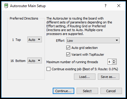

  3. There’s quite few settings here that you can adjust:
    You’re in complete control of the autorouter setup with settings for effort, CPU threads, and routing directions.
    • Preferred direction: if you need a specific direction of the route, like vertical or horizontal, select it for each layer or you can set it to Auto. N/A means that the autorouter will not use this layer.
    • Effort: this option defines how the autorouter will work, higher effort will take more time and will provide more more routing variances.
    • Number of threads: how many threads of the CPU you want the autorouter to use? This surely will affect the time it takes to finish.
      After selecting your settings, press the Continue button.

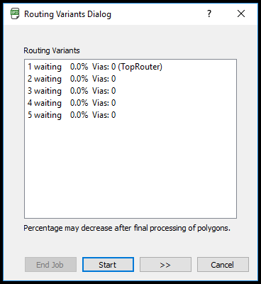

  4. Within the Routing Variants dialog, you’ll see a list of all the routing variations the autorouter will attempt. Select the Start button to begin the autorouting process.
    Eagle Autorouting with five potential routing variations
    Autorouting on a low effort mode produced five potential routing variations that the autorouter will attempt.
  5. Once the routing is complete, select the Evaluate button, and you’ll see your completion percentage in the bottom-left corner of the interface.
