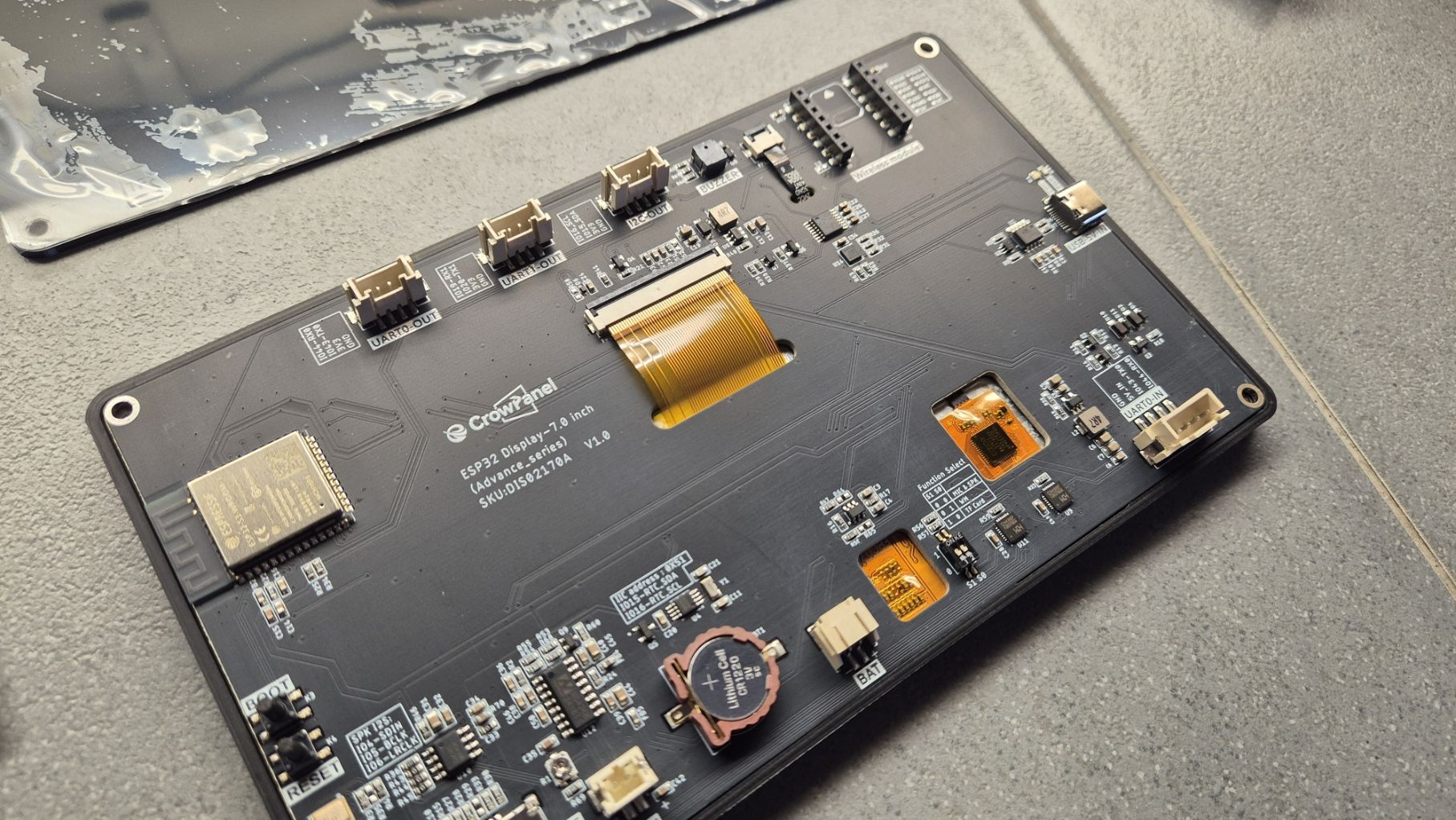

Powerful ESP32-S3 Module
The CrowPanel Advance’s core is the ESP32-S3-WROOM-1 module, which features an Xtensa 32-bit LX7 dual-core processor with a clock speed of up to 240MHz. This powerful processor is supported by 512KB SRAM, 8M PSRAM, and 16M Flash, providing ample storage and efficient processing for complex tasks. Built-in Wi-Fi and Bluetooth 5.0 capabilities ensure seamless wireless connectivity.
Memory and Storage
The CrowPanel Advance is equipped with enough memory and storage to run different applications without issues. It has a built-in 512KB SRAM and 8MB PSRAM that helps with smooth multitasking and fast performance. The device also has onboard 16MB of  Flash memory and 384KB of ROM to store apps, data, and settings. If users need more space, they can expand storage through external options. With this setup, the device can handle anything from basic tasks to more demanding applications for complex operations.

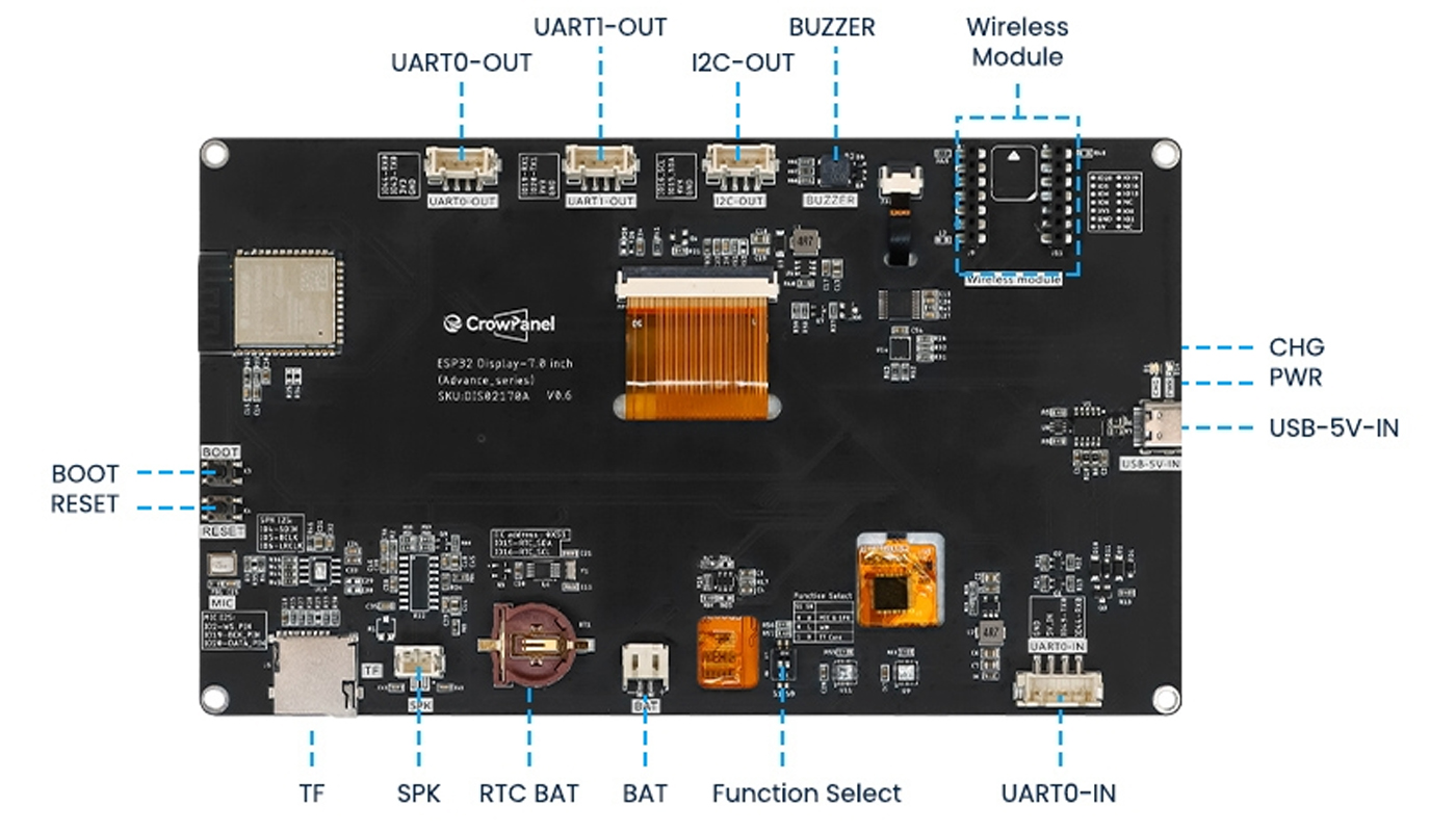

The CrowPanel Advance comes with various connectivity and expansion options to suit different needs. It has built-in Wi-Fi 4 (802.11b/g/n) and Bluetooth 5.0 (LE), making it easy to connect wirelessly to other devices and networks. For wired connections, several I/O interfaces like GPIO, I2C, SPI, and UART are offered, which allow sensors, modules, and other components to be attached by users. The device also supports add-ons and accessories, letting users expand its features as needed. Whether for IoT projects or industrial automation, dependable connectivity and flexible expansion options are provided by it.

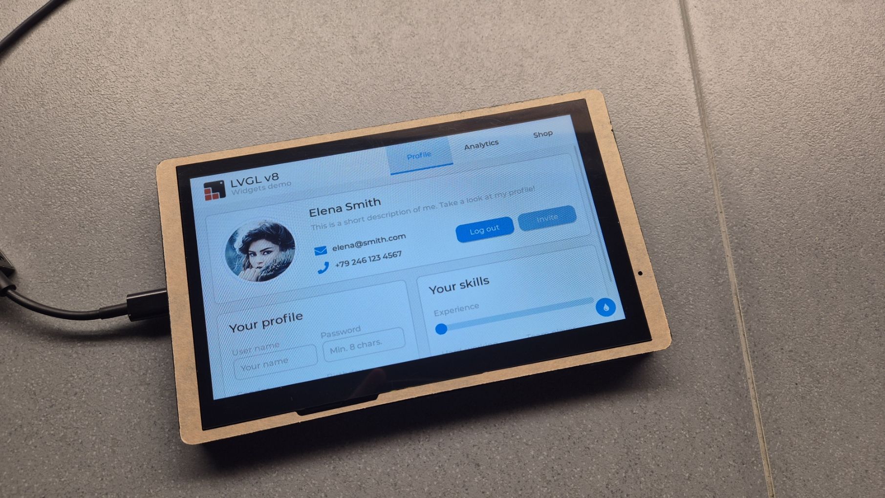

The CrowPanel Advance runs on FreeRTOS, a lightweight operating system designed for real-time applications. It uses the LVGL UI framework, which helps create smooth and user-friendly interfaces. The device is made fast and responsive by this combination while keeping resource usage low. With FreeRTOS, users can manage tasks efficiently, and the LVGL framework allows for easy customization of the display to fit different needs. Whether for industrial automation or home projects, a solid and reliable performance is provided by this setup.
Additionally, CrowPanel Advance works with various development environments like Arduino IDE, Espressif IDF, PlatformIO, and MicroPython. It also supports programming languages such as MicroPython and C++, allowing developers to use the tools they are most comfortable with. This flexibility is made suitable for both beginners and experienced developers, helping different projects to be worked on by them without any restrictions. Whether you’re building an IoT application or an automation system, the wide range of supported environments ensures a smooth development process to bring ideas to life.

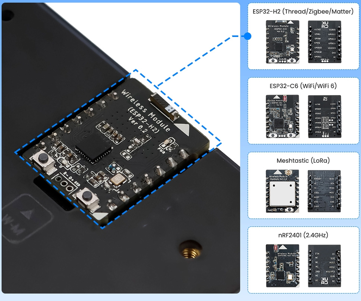

Replaceable Wireless Module Design
A significant improvement in the Advance series is the modular wireless design, allowing users to customize their connectivity options. The display supports a range of plug-in wireless communication modules, including:
  • ESP32-H2: Supports Zigbee, Thread, and Matter.
  • ESP32-C6: Provides WiFi 6 capabilities.
  • nRF2401: A 2.4GHz wireless communication option.
  • Meshtastic (SX1262): For long-range LoRa communication.
This modular approach makes the display highly flexible, and capable of adapting to many applications and environments with ease.

Additionally, the device is compatible with the LVGL graphics library, allowing users to create rich graphical interfaces with ease. For those looking to design custom UIs, the screen is also supported by SquareLine Studio, simplifying the UI development process.

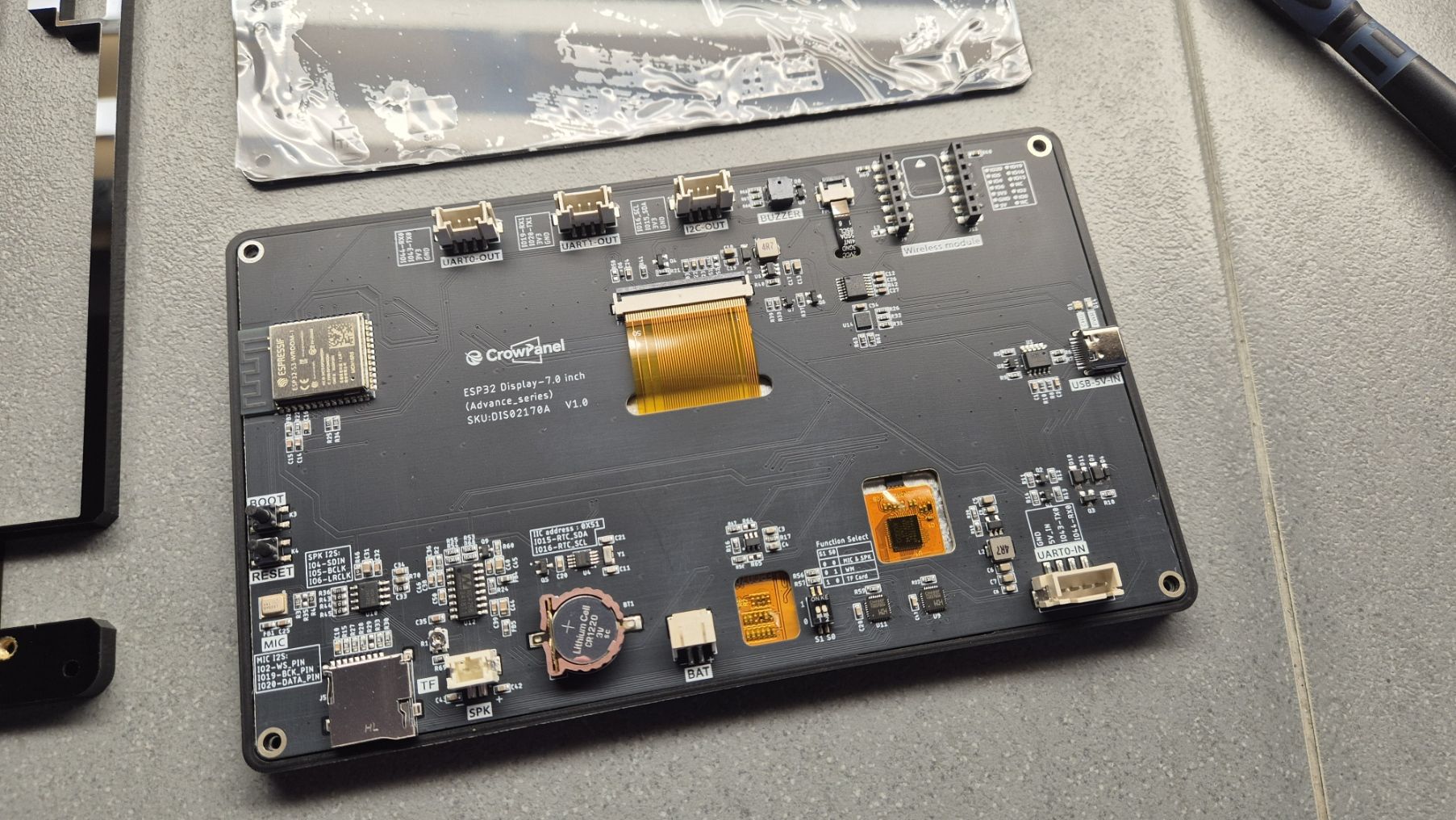

  • Real-time Clock (RTC) Function: Ensures timekeeping even during power failures.
  • Peripheral Ports: Includes USB, UART, I2C, SD card slot, battery socket, and audio interfaces.
  • Reset and Boot Buttons: Simplifies programming and resetting.
  • Power Management: Efficient battery charging and power monitoring capabilities.

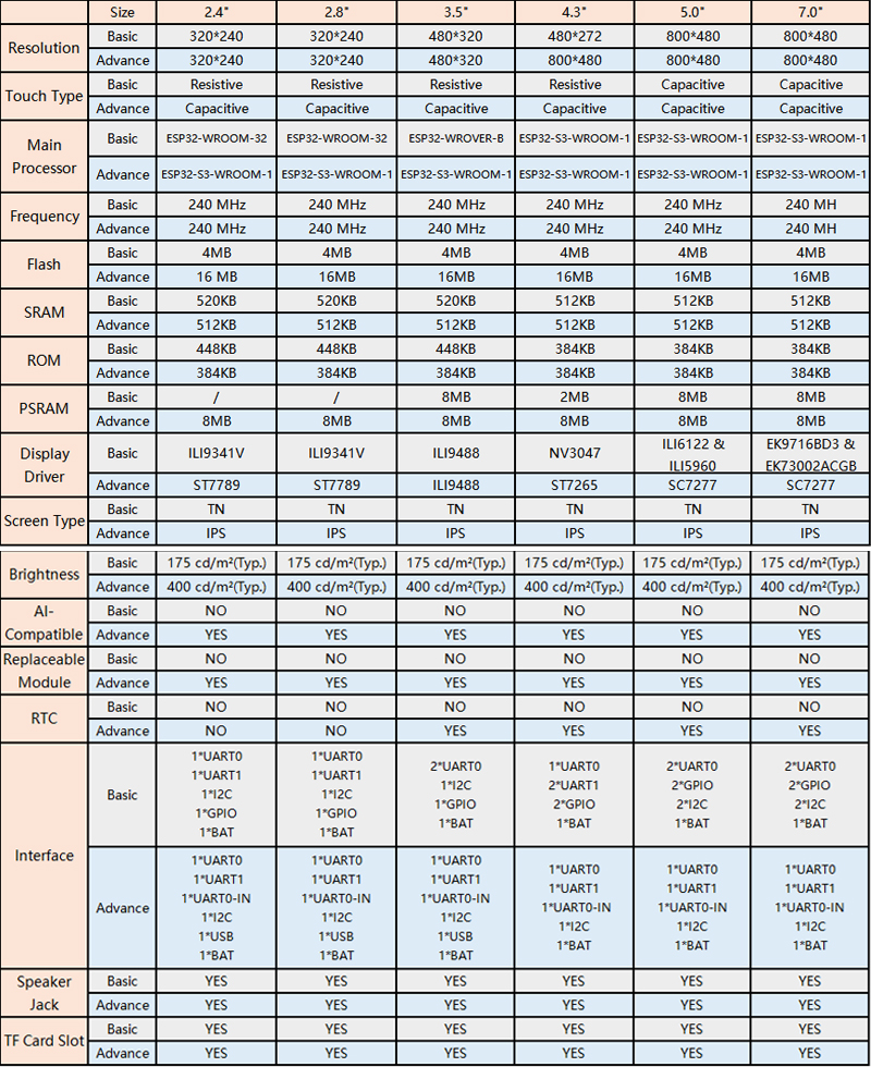

Comparison: Basic vs. Advance Series
Compared to the earlier CrowPanel Basic series, the Advance model offers significant improvements such as:
  • Enhanced Processing Power: Higher clock speeds and additional memory.
  • AI Features: Voice recognition and speech synthesis.
  • Modular Wireless Design: More connectivity options.
  • Better Touch Performance: More responsive capacitive touch.
These upgrades make the Advance series a much better option for users requiring higher performance and more features.

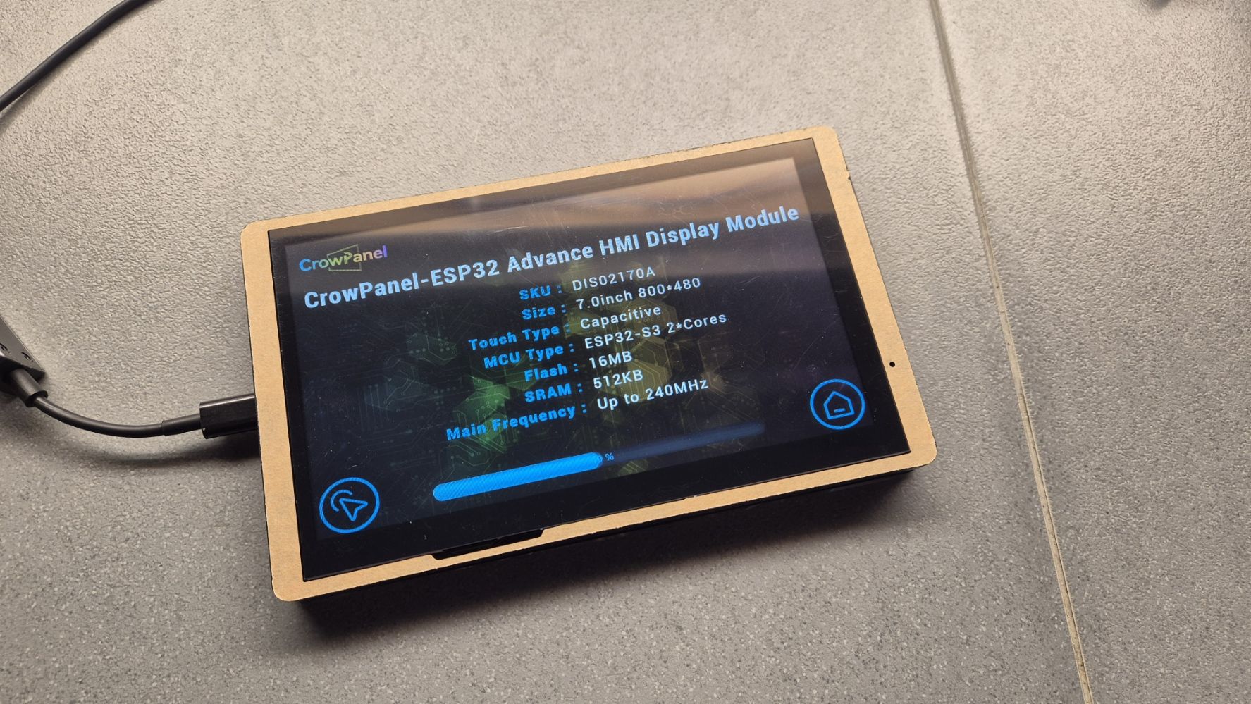

CrowPanel Advance 7.0 ESP32 AI Display Specifications
  • SoC: ESP32-S3-WROOM-1 module
  • Display:
    • 7-inch capacitive touchscreen with driver IC SC7277
    • IPS Panel with 178° wide viewing angle
    • 800x 480 resolution
    • 16.7 million colours
    • 178° Viewing angle
    • 400 cd/m² brightness
    • 16-bit colour depth
    • 156 x 87mm of Active Area
  • Audio:
    • Built-in speaker
    • Built-in Microphone
  • Storage:
    • 16M Flash
  • Connectivity:
    • Wi-Fi 4 (802.11b/g/n)
    • Bluetooth 5.0 (LE)
    • optional with add-on module (Zigbee, LoRa, nRF2401, Matter, Thread and Wi-Fi 6)
    • Semtech SX1276 module for LoRa connectivity (Meshtasic firmware for messaging)
    • nRF2401 module for low-power 2.4GHz connectivity
  • Interfaces:
    • 1x USB Type-C (power and data)
    • 1x RS485
    • 1x CAN bus
    • 1x MicroSD card slot
    • 1x 3.5mm audio jack
  • Expansion:
    • 1x 16-pin GPIO header
    • I2C, SPI, UART support
  • Buttons:
    • Reset Button (press to reset the device)
    • Boot Button (press and hold to burn the program)
  • AI Capabilities:
    • Face recognition
    • Voice recognition
  • Misc:
    • battery socket
    • battery charge management
    • RTC clock
    • audio amplifier
    • volume control
    • USB to UART
    • Power indicator
    • Lithium battery charging status, completion indication
  • Power Supply:
    • 5V/2A via USB Type-C
    • 12V input via UART terminal block
  • Operating Temperature: -20°C to 70°C
  • Storage temperature: -30~80 °C
  • Dimensions: 190mm x 110mm x 20mm
  • Weight: 450g
  • Certifications: CE, FCC, RoHS
  • Mounting Options: VESA-compatible

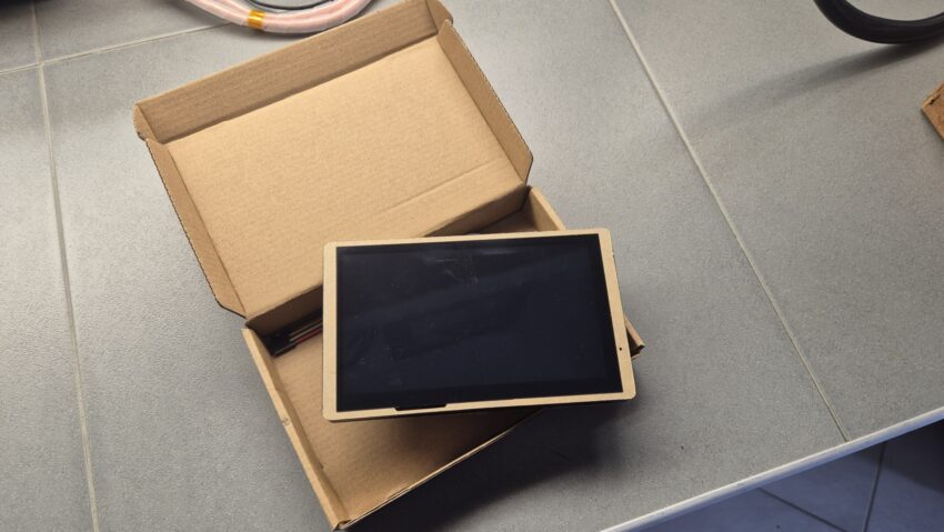

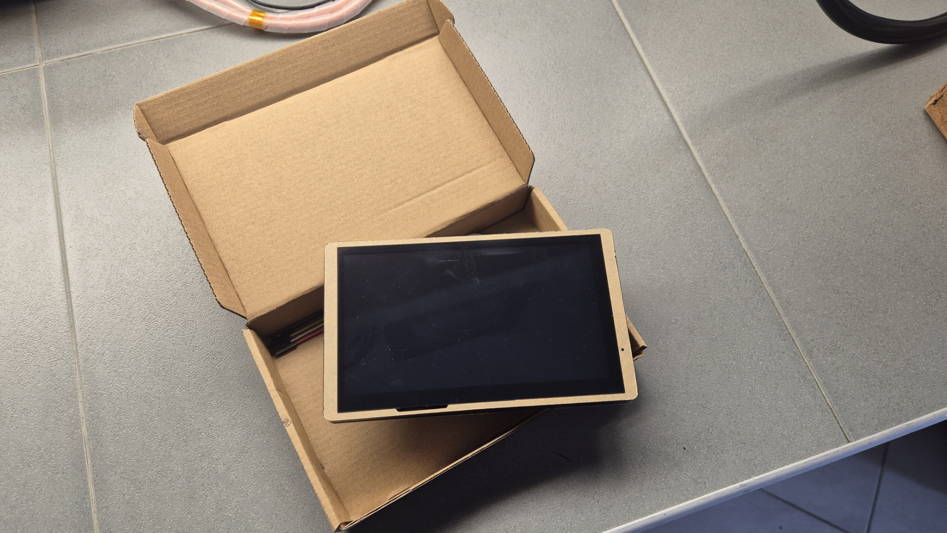

Package Contents
The CrowPanel Advance package includes:
  • 1 x CrowPanel Advance 7.0-HMI ESP32 Display
  • 1 x Power Cable
  • 1 x USB Cable
  • User Manual
Optional add-ons such as the Acrylic Case and different wireless modules can be purchased separately.
