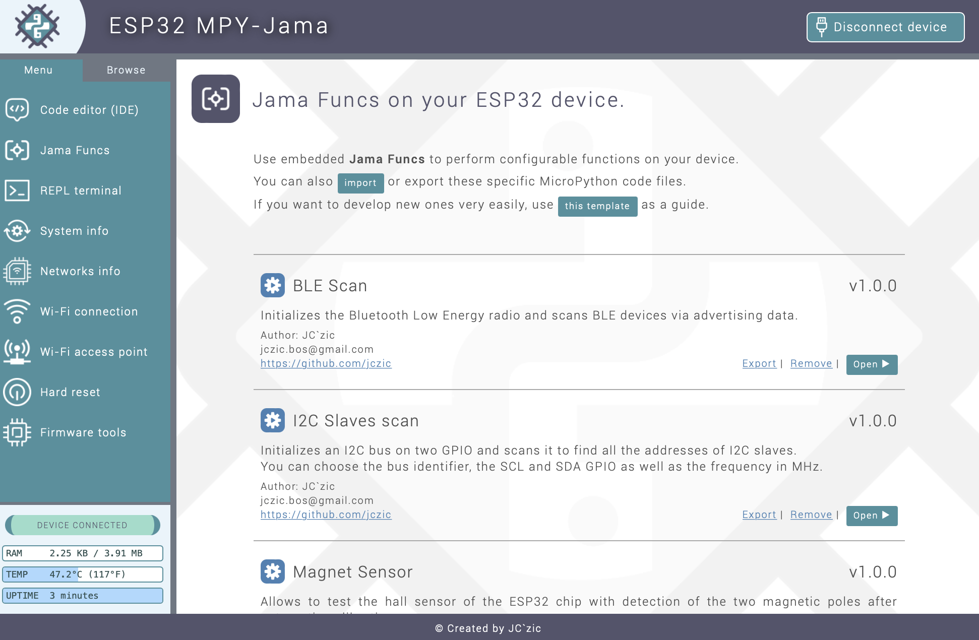

Other IDEs, such as Thonny and Mu, have the essential features, but ESP32 MPY-Jama stands out due to its additional capabilities. For instance, it comes with a suite of tools called Jama Funcs, which are pre-built functions to help configure the device. Furthermore, the Wi-Fi connection tools make it simple to search for available networks and connect MicroPython to them.

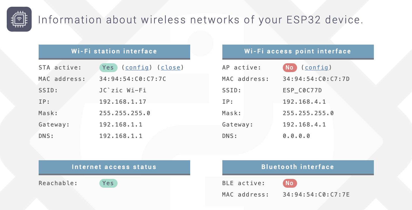

The GUI has a widget in the bottom-left corner that always displays real-time information such as RAM usage, temperature sensor, and how long the board has been running. Additionally, the System Info section provides additional details that can be accessed without having to type commands on the REPL, such as the version of code on the device, as well as a real-time read-out of the GPIO pin state.
