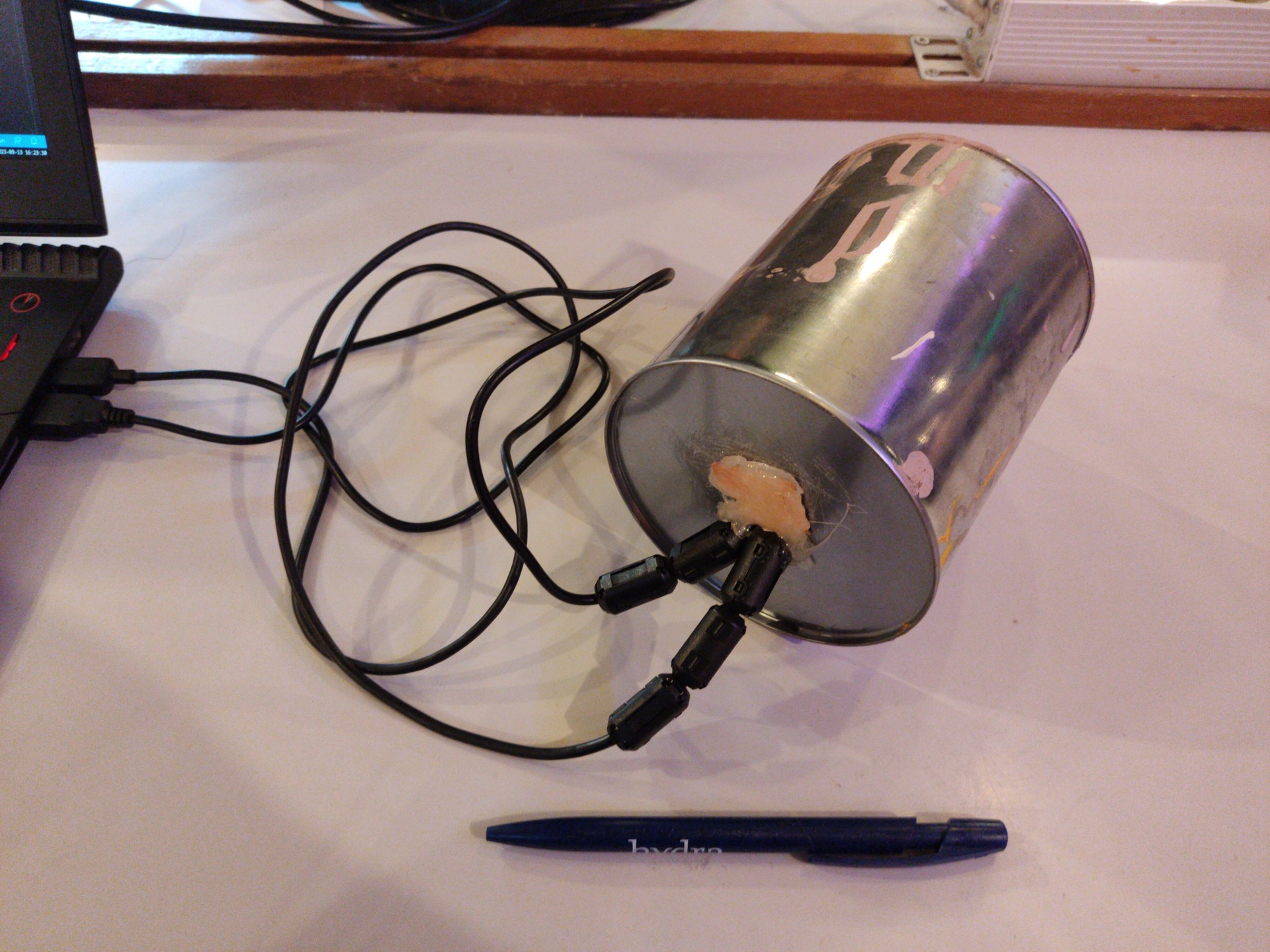

We connect [the] antenna connector to a 60dB attenuator (this weakens the signal by 60dB),” Devreker continues, “then connect that to the antenna connector of the wireless dongle. That way, we’ll be able to receive only the packets coming from the ESP32, and the ESP32 will only receive packets sent by the wireless dongle.
By placing the device in a Faraday cage and using the mentioned method, they analyzed the hardware’s lifecycle during packet transmission. This led to the development of proof-of-concept firmware, enabling independent packet transmission and reception without relying on Espressif’s SDK.
