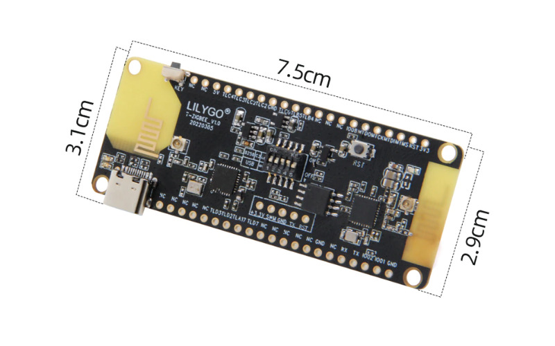

Specifications of the T-Zigbee Board
  • MCU: ESP32-C3 RISC-V processor that supports Wi-Fi 4 and Bluetooth 5.0 LE connectivity and TLSR8258 multi-protocol radio controller
  • Antennas: Features 2x PCB antennas and 2x u.FL antenna connectors
  • USB: 1xUSB Type-C port for programming and power
  • Misc: Provides reset and user keys and for UART/programming selection between the ESP32-C3 and TLSR8258, the board provides a DIP switch
  • Power supply: 5V via the USB Type-C port
  • Dimensions: 7.5 x 2.9 cm
LILYGO T-Zigbee ESP32-C3 Board
The MCU development board provides 21 general-purpose input/output (GPIO) pins shared between the two processors. It offers four analog inputs, three UART, two I2C, two SPI, a digital MIC, PWM, and I2S buses. The board also offers three user-controllable LEDs, a reset, and a single-user addressable button.
