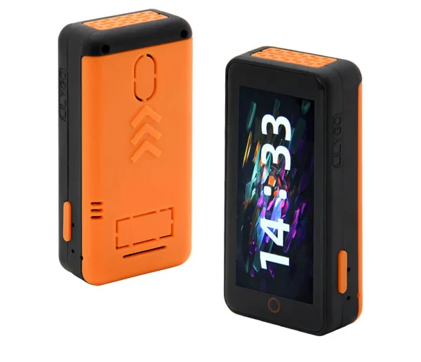

LILYGO has announced a new model of T-Pico all-in-one development kit known as the T-Pico-2350. It is a fully integrated devkit featuring a Raspberry Pi RP2350A MCU and an Espressif ESP32-C6 SoC for wireless connectivity. The design is an update to the T-PicoC3 introduced in 2022, with the case design of the T-Display S3 Pro.

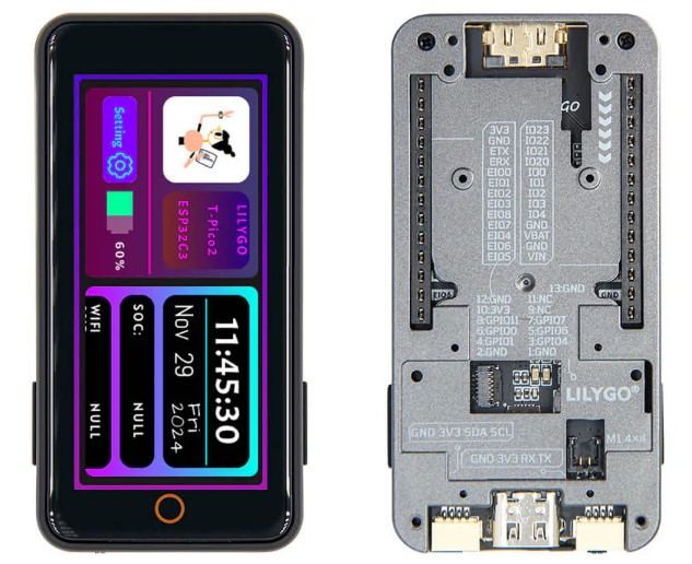

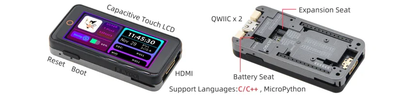

T-Pico-2350 devkit, also called T-Pico2, comes with a 2.33-inch capacitive full-color IPS touchscreen display, an HDMI (DVI) video output port, a microSD card slot, a USB-C port for power and programming, two GPIO headers, a 13-pin GPIO FPC connector, two Qwiic I2C/UART connectors, and a PMU for battery management.
T-Pico-2350 Raspberry Pi development kit

In terms of software, LILYGO T-Pico 2350 supports C/C++ and MicroPython as the supporting languages. LILYGO provides Arduino samples for all features, including the PDF schematics, the RP2350 and ESP32-C6 firmware for the devkit, and basic instructions to configure the Arduino IDE or PlatformIO on GitHub.
