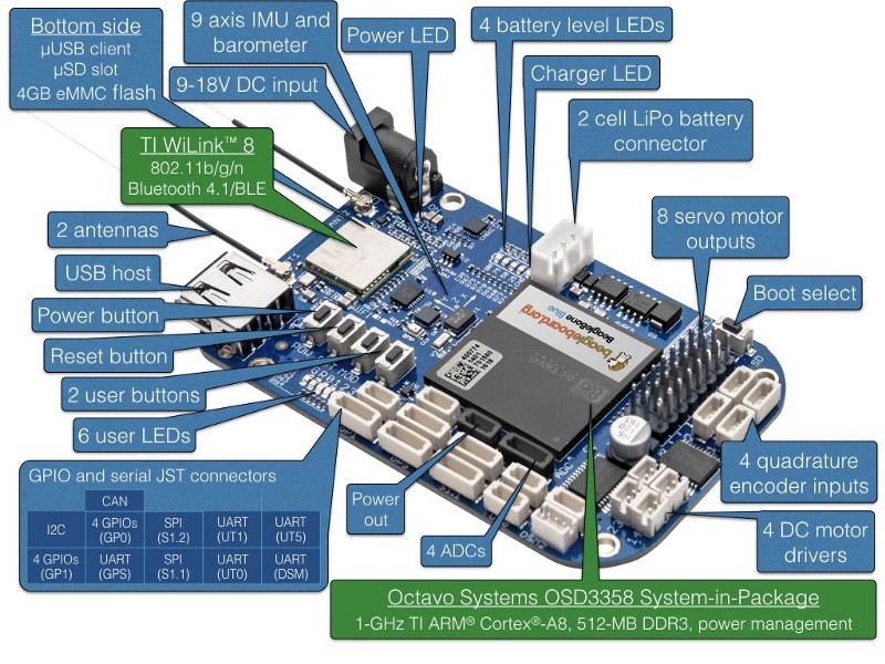

A new development board by BeagleBoard has been just unveiled: BeagleBone® Blue! The new board is dedicated for designers, hobbyists and professional featuring a Linux-enabled robotics controller complete with an extensive set of peripherals for building mobile robots quickly and affordably.
It is easier today to build your robot using BeagleBone Blue since it has onboard 2 cell (2S) LiPo battery management with charger and battery level LEDs, 8 real-time software controlled PWM/PPM outputs for 6V servo motors or electronic-speed-controllers (ESCs), 4 PWM-enabled DC motor drivers, 4 quadrature encoder inputs, on-board sensors including a 9-axis IMU and barometer, a wide array of GPIO and serial protocol connectors including CAN,4 ADC inputs, a PC USB interface, a USB 2.0 host port, a reset button, a power button, two user configurable buttons and eleven user configurable LED indicators.
BeagleBone Blue also has a pre-configured Wi-Fi access point that enables the process of connecting a battery and coding through a web browser. The board is compatible with Debian, ROS, and ArduPilot software, in addition to Cloud9 IDE on Node.js and other graphical programming options.

  • Processor: Octavo Systems OSD3358 1GHz ARM® Cortex-A8
    • 512MB DDR3 RAM
    • 2×32-bit 200-MHz programmable real-time units (PRUs)
    • 4GB 8-bit on-board flash storage programmed with Debian Linux distribution
  • Connectivity and Sensors:
    • Battery: 2-cell LiPo support with balancing, 9-18V charger input
    • Wireless: 802.11bgn, Bluetooth 4.1 and BLE
    • Motor control: 8 6V servo out, 4 DC motor out, 4 quadrature encoder in
    • Sensors: 9 axis IMU, barometer
    • Connectivity: HighSpeed USB 2.0 client and host
    • Other easy connect interfaces: GPS, DSM2 radio, UARTs, SPI, I2C, analog, buttons, LEDs
