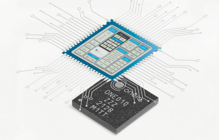

Based on Arm Cortex – M4f CPU, the Onera Biomedical-Lab-On-Chip is equipped with a multi-channel sensor readout system along with built-in power management, data processing, and interfacing features. It supports on-chip biomedical sensing and data retrieval with ten readouts for ExG, including EEG, ECG, EMG, EOG, and two readouts for photoplethysmography along with two bioimpedance readouts. The chip also embeds a 320kB SRAM and 768kB flash, along with embedded digital filters and an accelerator block which features a data compactor, sampling block, processor, FIFO, and DMA and synchronization engines all of which facilitate on-chip data processing and support for a broad range of wearable health applications and devices.
Designed for use in wearable devices and applications across the medical health and wellness industry, the Biomedical-Lab-on-Chip features digital interfaces like SPI, I2C, I2S, UART, and GPIOs which aids its integration with other subsystems.
