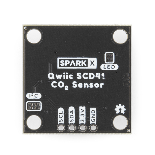

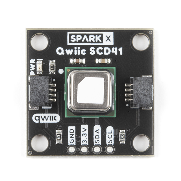

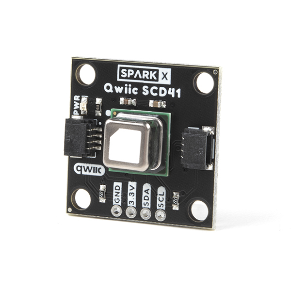

Essentially a breakout board for the highly accurate, miniature, and Photoacoustic sensing-based SCD41 CO₂ sensor from Sensirion, the Sparkfun’s SCD41(QWIIC) CO₂ Humidity and Temperature Sensor possesses the capacity to detect CO2 over a large output range from 0 to 40000 ppm with higher accuracy over 400-5000 ppm ±(40ppm+5%) range, with accuracy further improved by the On-chip signal compensation realized via the built-in SHT4x humidity and temperature sensor.
