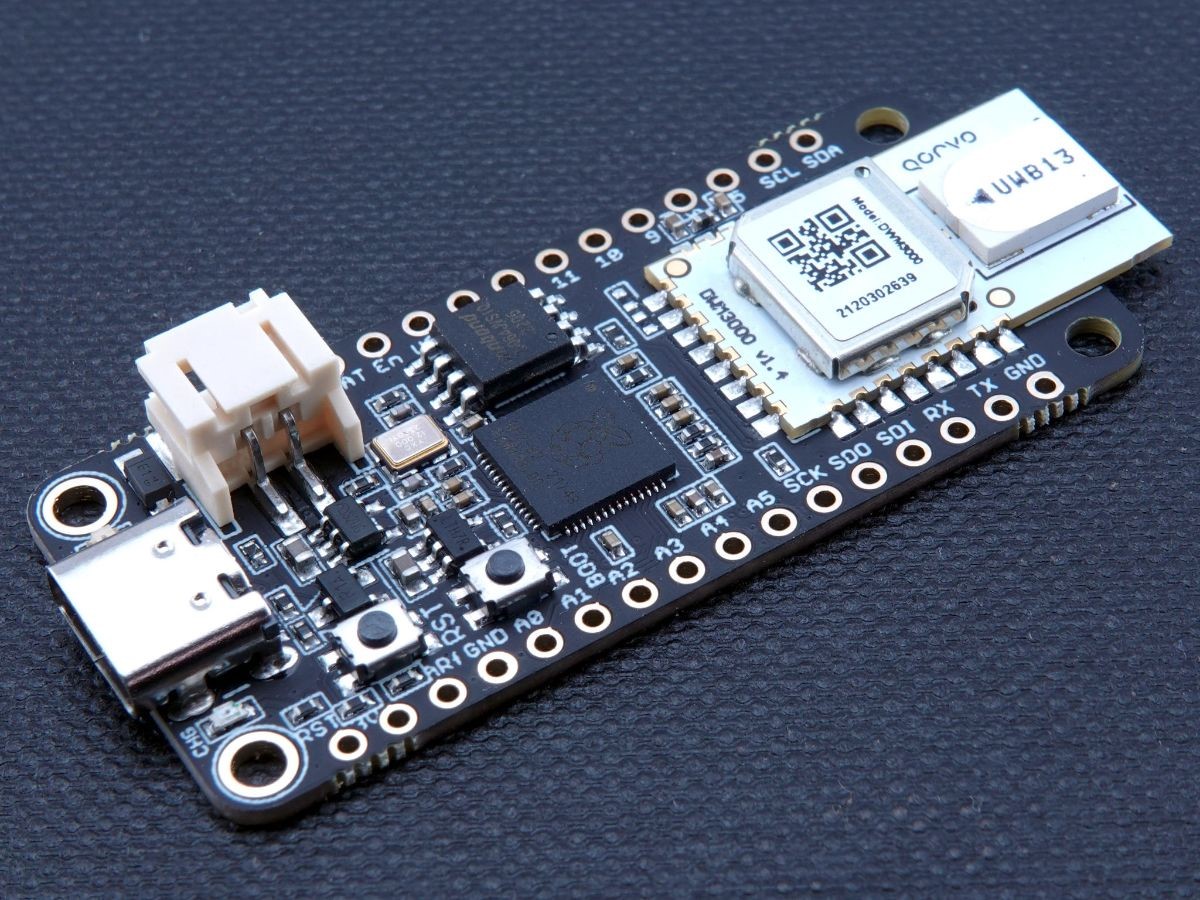

Eis is powered by the Lattice ICE40HX4K FPGA. The Lattice ICE40HX4K FPGA is an ultra-low power, non-volatile FPGA fabricated on an advanced 40nm CMOS low power process and with flexible logic architecture, embedded and distributed memory, programmable low swing differential I/Os, up to 2 analog PLLs (Phased Locked Loops) and 7680 LUTs (Look-Up Tables).
The board also comes with the high-performance low-cost RP2040 MCU, Raspberry Pi’s debut microcontroller with large on-chip memory, a rich peripheral set augmented with a unique Programmable I/O subsystem, and a polished micropython port. There are also other features embedded inside the FPGA-based board including one Digilent Pmod compatible expansion port, one MMOD socket, one microSD card slot, and one DDMI port with support for DVI output over HDMI cable.
The board is actually smaller than a credit card, measuring 80 mm by 40 mm. It shares similar features with one of Machdyne’s other products named Riegel. “Eis is a slightly smaller reimagining of Riegel,” the company also said, comparing the two boards. One notable difference between the two, however, is that:
“Eis has a USB keyboard port and DVI over HDMI video output instead of PS/2 and VGA.”
