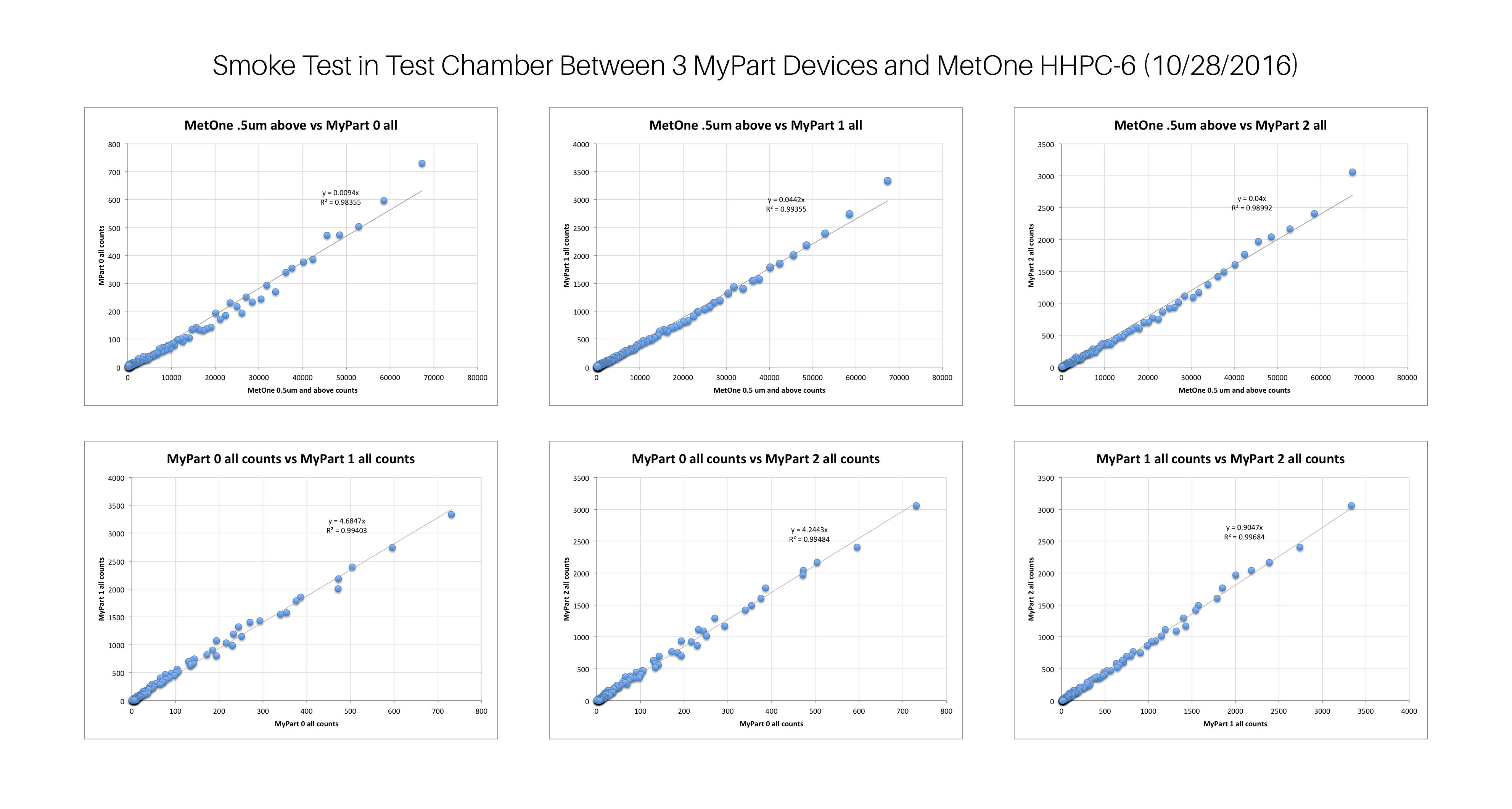

In the test chamber, smoke concentration was allowed to decay naturally over about 2 hours. Three prototypes of MyPart gave similar accuracy results to an expensive instrument results ($5000 MetOne HHPC-6).
Additional experiments conducted with calibration particles of known sizes and in outdoor ambient environments, and more information about the tests can be found here.
