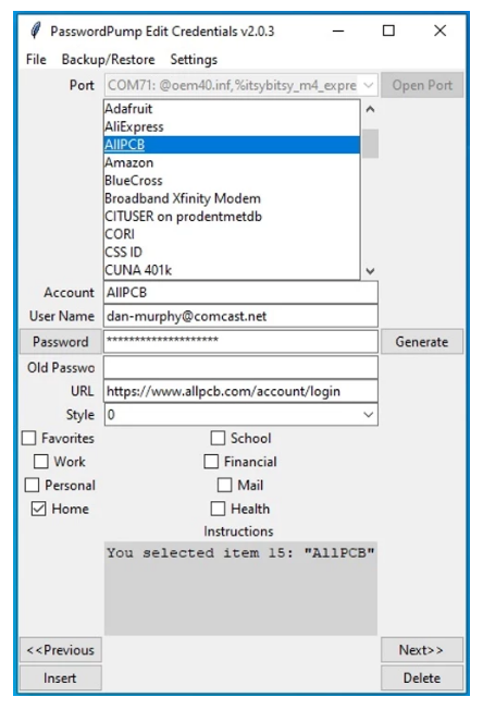

The device allows users to enter their credentials using several methods, including; the rotary encoder, the keyboard, via the serial terminal, or via the PasswordPump Python-based GUI, which was explicitly developed for this purpose.
