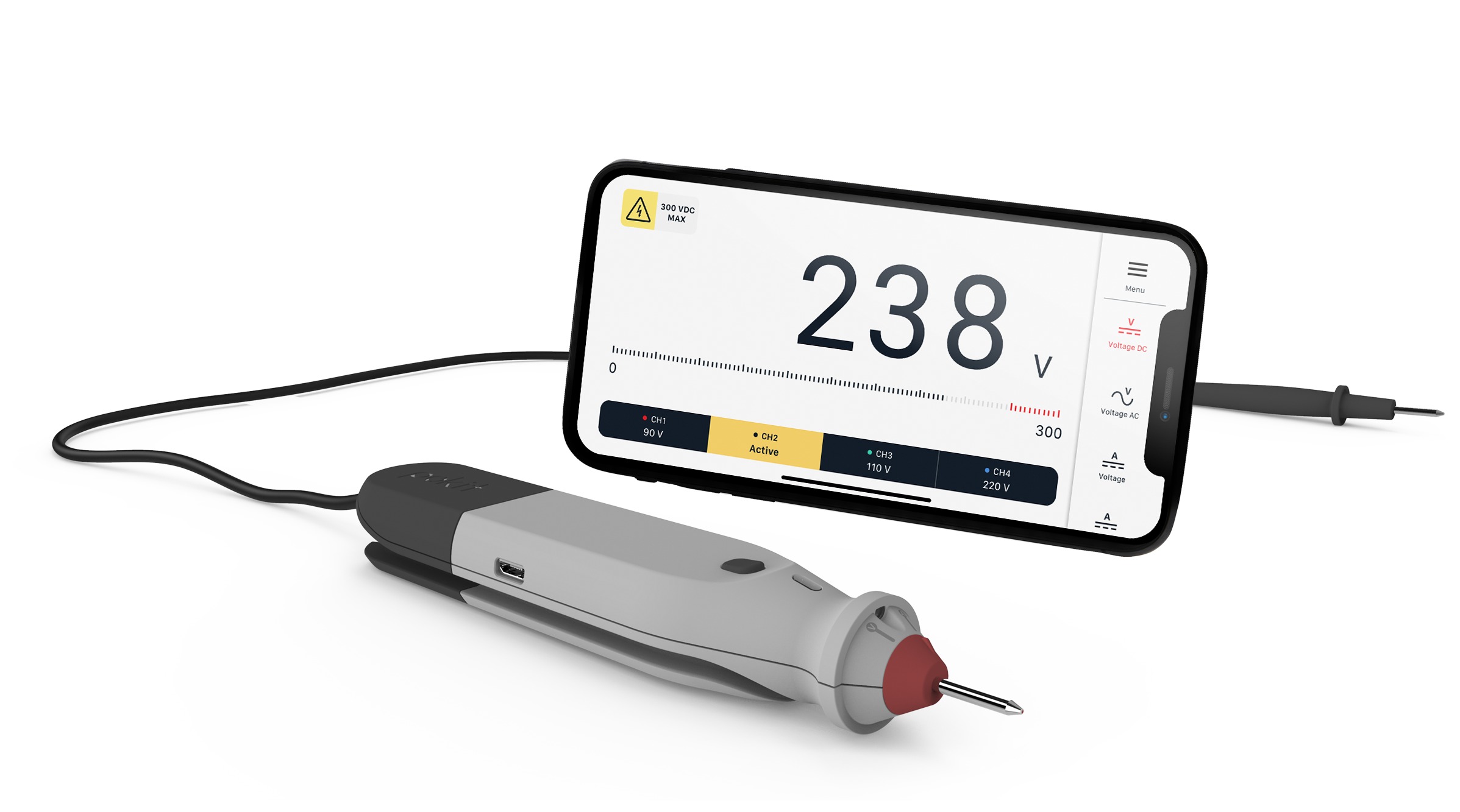

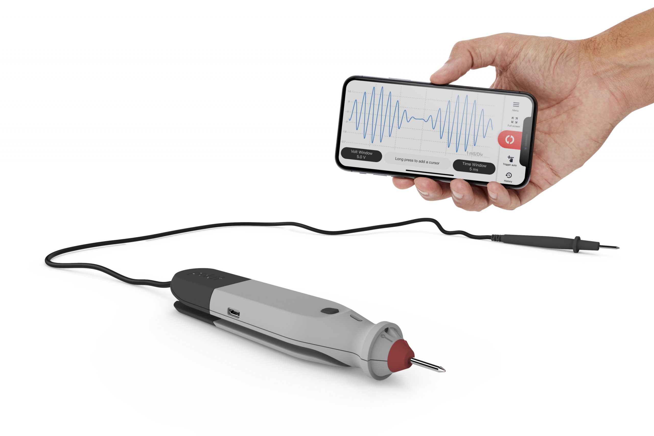

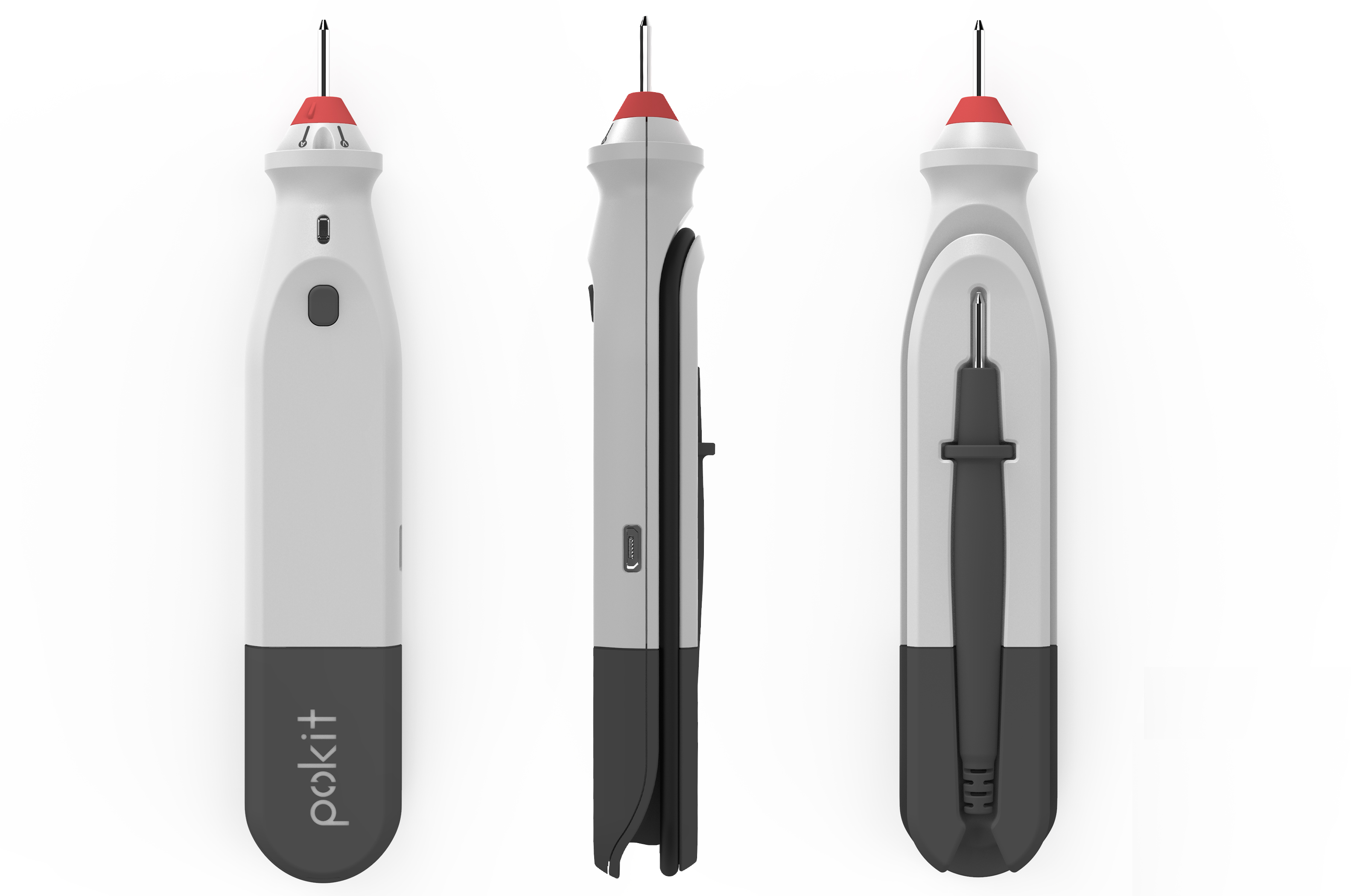

Pokit Pro is all in one multimeter, DSO, and logger for portable electronics testing and measurements. Hence, it is an excellent option for makers, technicians, and engineers as its portable feature allows them to carry it anywhere they want. Adding more to the mobile quality, the device has a pen-style design structure that can easily fit in the pockets. Also, the Pokit Pro is budget-friendly without a “prohibitive price tag.”

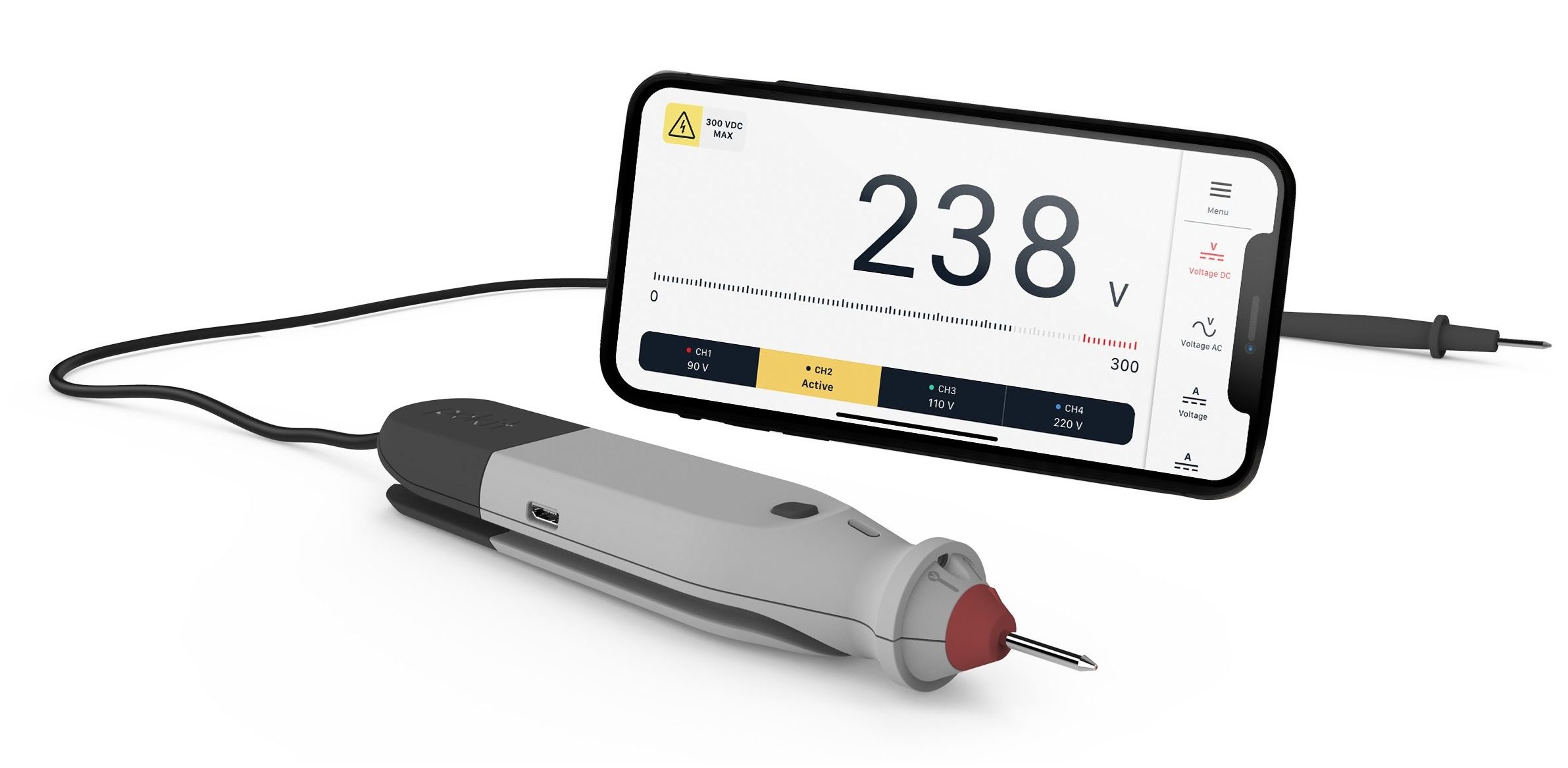

You might have seen numerous multimeters and DSO, which have a lot of specifications. But Pokit Pro comes with wireless functionality, enabling connectivity to the smartphone app to measure a wide range of electrical and electronic quantities. These quantities include voltage, current, resistance, capacitance, and temperature. So, the wireless connectivity is via Bluetooth technology with a range of 10 meters. Further, Pokit Pro also allows continuity and diode checking in complex circuits.

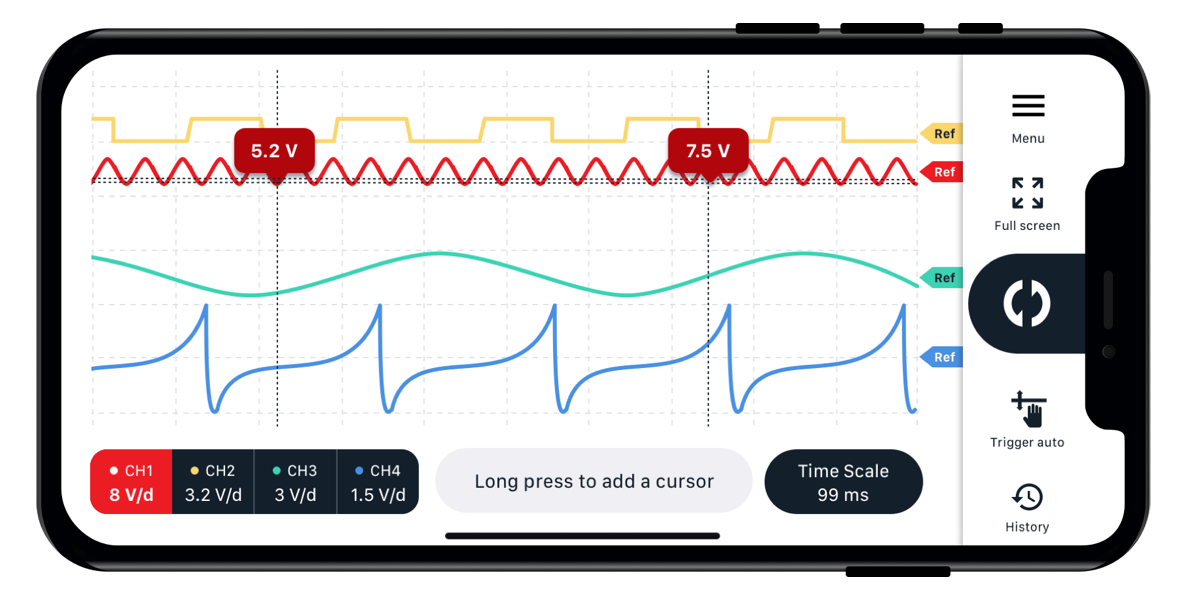

The Oscilloscope of Pokit Pro comes with additional features like an acquisition button, continuous sampling, trigger, and multichannel measurements. Channel naming, RGB channel identification, and Digital Fourier Transform are also some of the functionalities.
