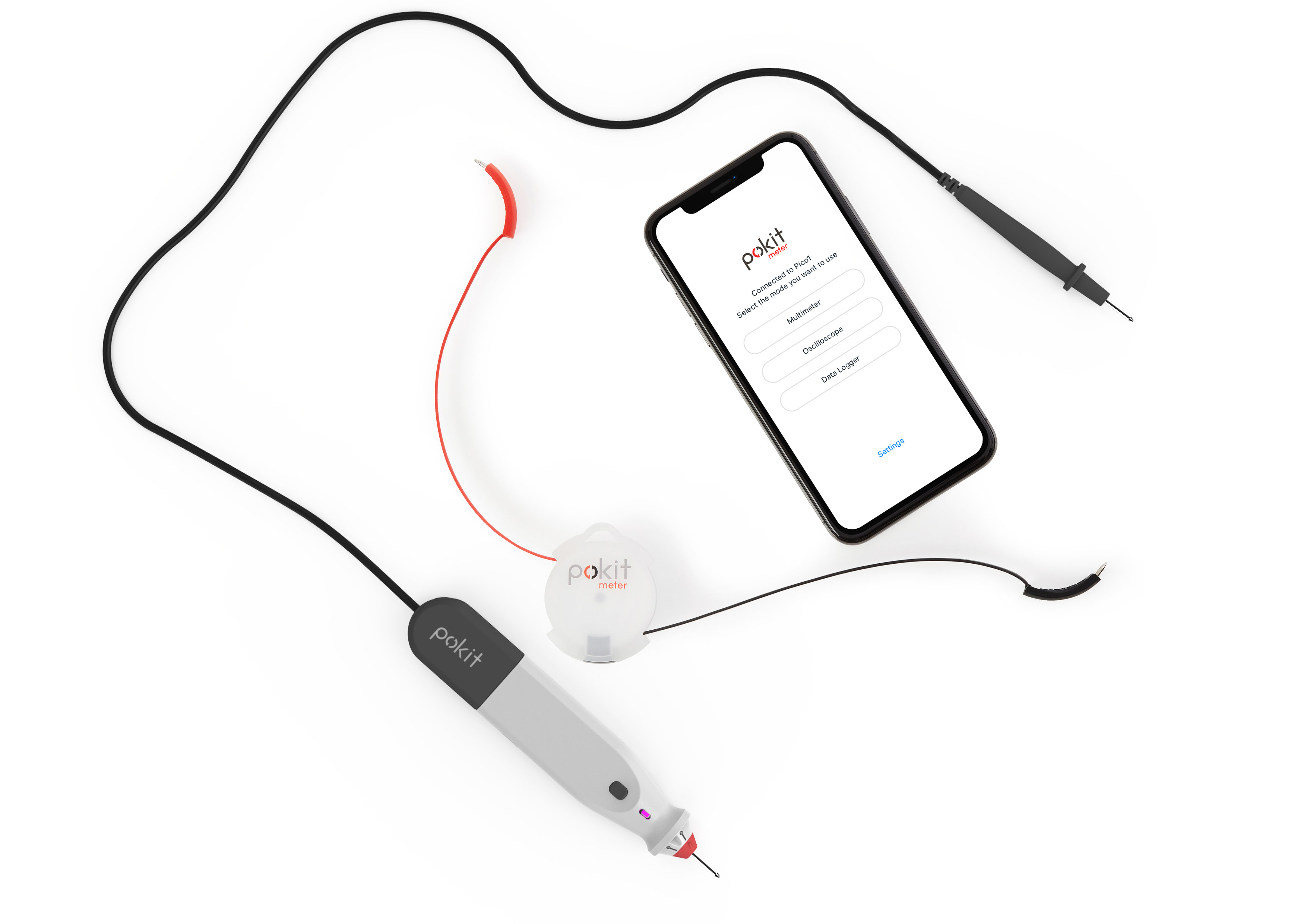

Enhanced functionality opens the door to new use-case possibilities. Pokit PRO is a full-featured multimeter, accurately measuring AC/DC voltage, AC/DC current, resistance and ambient temperature, as well as checking continuity and diodes. Pokit PRO’s 600V RMS (CAT III) voltage range extends pokit’s applications to include higher-voltage household, lighting, automotive and electronics work.
Pokit PRO has been optimised for heavy duty work through its water resistant housing and high quality materials. Pokit PRO also comes with a whole bunch of other exciting new features, including an integrated torch, rubberised grip and rechargeable battery.

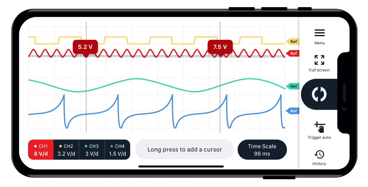

Pokit PRO’s enhanced digital storage oscilloscope functionality supports multichannel use, connecting up to four devices simultaneously. Waveforms can be captured, displayed in real-time on a smartphone, and then saved for export to a CSV file. You can even perform an FFT spectrum analysis directly within the app! Pokit PRO fosters a creative community through its open-source API, which allows users to create their own pokit integrated apps and share them with others.

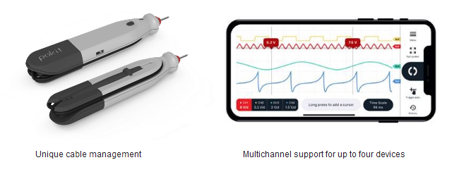

  • Multichannel support. Connect up to four Pokit PRO’s to your phone to measure more

Innovators can move beyond the bench through a uniquely compact design. Traditional electronic measurement tools are bulky, expensive and complicated. Pokit PRO has been thoughtfully designed to mobilise innovators, allowing them to take their creativity anywhere. Pokit PRO’s innovative cable management system neatly stores the leads in the body of the device, increasing portability.

You have to touch points of the wave form to see the bandwidth measurement. Id hardly call it crap if you can transform your phone which is a microcomputer into a multimeter and oscope is hardly a waste of money. An oscope you can take anywhere that fits in your pocket? That sir is not crap.
Paul
Cyk the bandwidth is on the Kickstarter FAQ. It’s 600 kHz. So this is less than a conventional desktop scope, but for sub $100 its pretty amazing and ok for work up to ultrasonic frequencies.
