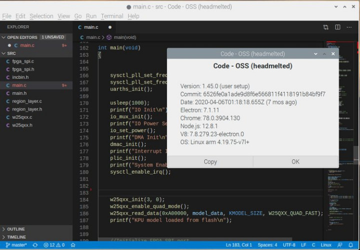

XaLogic K210 AI Accelerator functions best with Raspberry Pi Zero and camera and enables you to make use of pre-trained models for evaluation such as object detection, face detection, age, and gender estimation,  simple voice commands, and vibration abnormally detection. You can also train your own model using a more powerful host machine. You can make use of an NVIDIA GPU, with TensorFlow. You can make use of TFLite, Caffe, and even ONNX format through the aid of conversion tools. You can make use of Visual Studio Code, which is recommended by XaLogic to modify K210 C code directly on Raspberry Pi if need be. With the aid of the Visual Studio Code for Raspberry Pi and the pivotal toolchain for the K210, you can develop all the K210 firmware on the Pi itself. The K210 AI Accelerator features an Infineon Trust-M onboard which enables you to establish a secure connection to AWS through MQTT without exposing the private key. This feature is important for your privacy when you are deploying your IoT devices in the field.
