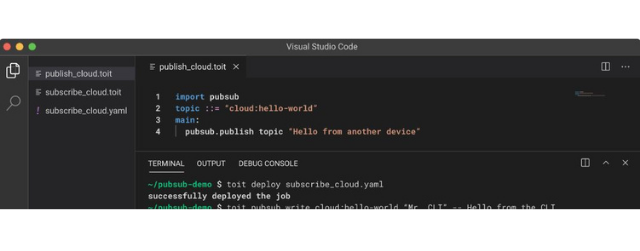

To Write And Deploy Applications, Use The Visual Studio Code Extension
VS Code Extension
Toit introduced a Visual Studio Code extension that does much more than merely highlighting the code with the introduction of a new programming language. In the built-in terminal, users may run code snippets, deploy programs, and monitor the output. The extension also displays a list of devices and apps that are currently operating in the sidebar. This Visual Studio Code extension speeds up development. We loved the fact that we could execute the software directly on the device, just as we would a computer program. There is no need to worry about picking a port, flashing, or any other issues that can arise while dealing with C++ programs. Overall, this VS code extension provides all of the fundamental functions of the web-based interface, as well as additional app deployment options.
