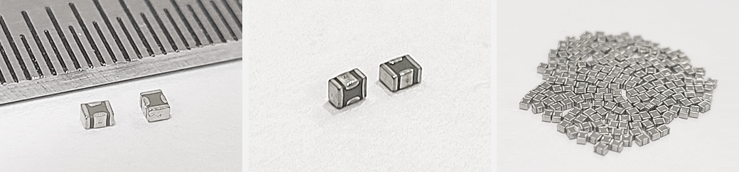

Samsung is taking on Murata with a 1209 MLCC that is 18 percent thinner at 0.65mm and replaces four other devices in 5G smartphones. By Nick Flaherty @ eenewseurope.com Samsung Electro-Mechanics has developed a 0.65mm 1209 format multilayer ceramic capacitor (MLCC) for 5G smartphones that is 18 percent thinner than previous products.
Samsung Electro-Mechanics has developed a 0.65mm 1209 format multilayer ceramic capacitor (MLCC) for 5G smartphones that is 18 percent thinner than previous products. It plans to use the technology to overtake Murata, which makes over a trillion devices a year, as the world’s largest MLCC supplier.
The 3-socket MLCC adds an earth socket to the general MLCC for reduction in high-frequency power noise filtering and can replace three to four two-contact MLCC devices.
The 1209 format measures 1.2 x 0.9mm and the smaller thickness of 0.65mm was achieved applying independent thin layer molding technology and a superfine dielectric layer. This reduced the thickness from 0.8mm.
