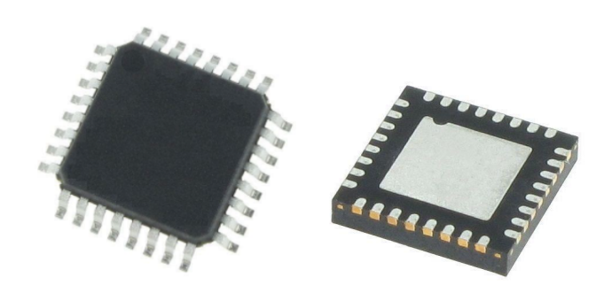

Taking the ATMEGA328P example again, AU takes the form of the slightly larger leaded TQFP package and MU comes in the leadless VQFN variety but the two are otherwise identical in terms of functionality and performance. By changing to the AU package, one could save over half on the MU package. Find out more ATMEGA alternatives here.
TQFP package versus VQFN

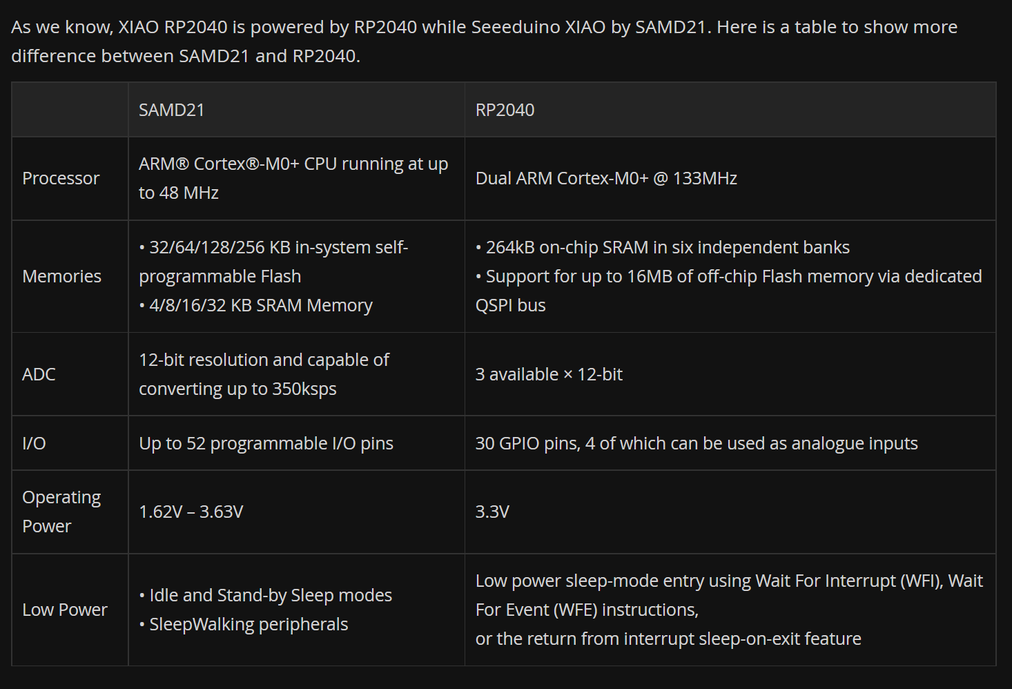

Since the pandemic began, Raspberry Pi has released headlining products including the new form factor compute module 4 (CM4) which is available in many configurations, and their own Raspberry Pi RP2040 dual ARM Cortex-M0+ chip that comes at a fraction of the cost of ATMEGA 8-bit chips (even at retail price) and competing for 32-bit chips such as Microchip’s SAMD21G18. Now with Arduino support, RP2040 is a strong viable alternative for small low-power microcontroller projects and applications using Arduino IDE. But most notably, the RP2040 chip is plentiful in supply and Raspberry Pi chief Eben Upton has assured users that there is plenty of silicon to go around thanks to a new silicon wafer production process. As Upton put bluntly,

Comparison of SAMD21 and RP2040 microcontrollers
