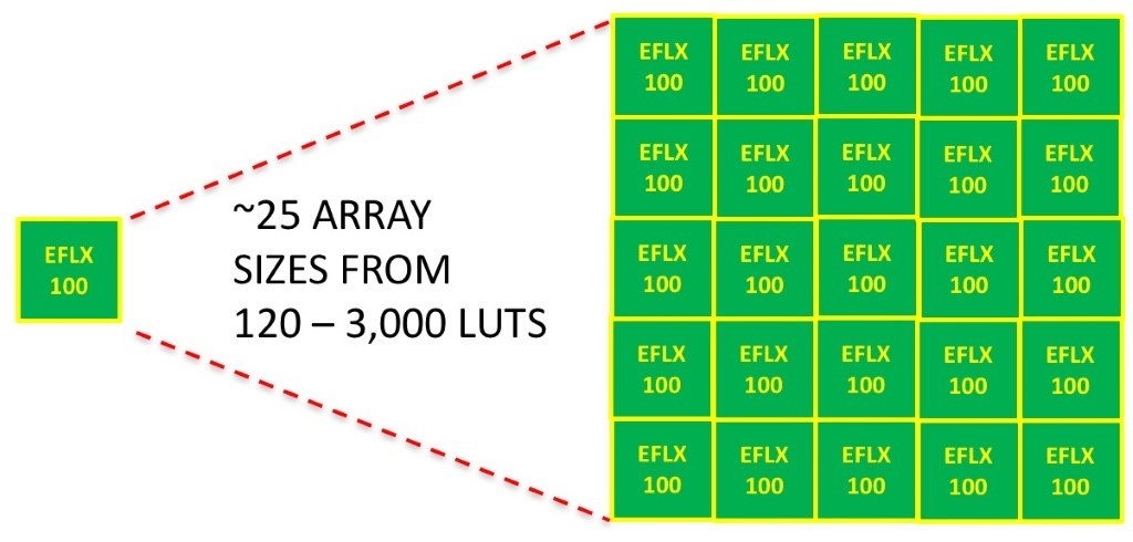

One key advantage of eFPGA is the ability to allow customers to design chips in whatever size or configurations array they require. For example, if a customer is designing in 16nm, they might only require a few hundred LUTs of programmable logic for fast reconfigurable control logic running at ~1GHz. In contrast, another customer in the same process may want 50K-100K LUTs for a datacenter processor accelerator. With Flex Logix, the way that can be achieved is by using tileable building blocks. First, 4 EFLX IP cores are designed using the above approach. Each IP core is a stand-alone FPGA, but they can also be arrayed to offer EFLX arrays, about 75 in total, from 100 LUTs to 122.5K LUTs, with any mix of logic/DSP.
Each EFLX IP core has an extra top-layer of interconnect which allows one core to connect automatically to surrounding neighbors to make a large array up to NxN.
EFLX-100 arrays up to 5×5 or 3,000 LUTs (there are actually 120 LUTs in an EFLX-100).

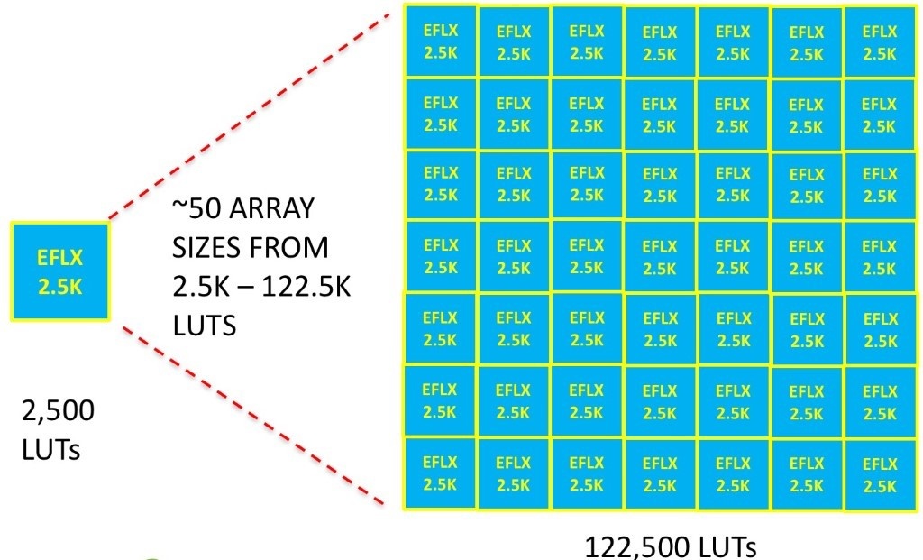

EFLX-2.5K takes over at 2500 LUTs and arrays up to 122.5K LUTs.

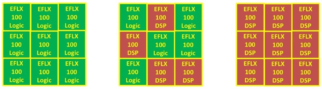

An array can be all-logic or all-DSP or any mix of the two types of cores:
