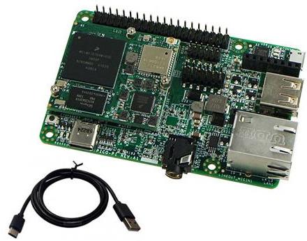

A few years ago, one of Google’s hardware partners, TechNexion, launched a 2 board development kit that consists of a System-on-Module and a carrier baseboard – the PICO-PI-IMX7. PICO-PI-IMX7 is a highly-integrated single board computer with enhanced features designed to enable secure and portable IoT applications.
PICO-PI-IMX7 is a highly-integrated single board computer with enhanced features designed to enable secure and portable IoT applications. It is aimed at facilitating fast prototyping and product development at predictable scaling costs.
Designed around the popular Pi (85 x 56 mm) form factor, the PICO-PI-IMX7 is equipped with an NXP i.MX 7Dual dual-core Cortex-A7 processor @ 1 GHz with Cortex-M4 real-time core, 512MB DDR3L, 4GB Wi-Fi, 802.11 ac & Bluetooth 4.1.
PICO-PI-IMX7 is lauded for its exceptional processing and low-power performance, thus suitable for a wide range of applications ranging from simple IoT devices to high-level complexity applications. It has been tested and proven to run Android Things, Linux, Yocto, Ubuntu, and Android at optimal performance.

PICO-PI-IMX7 is currently available in case you’re interested in buying one for yourself. Arrow Electronics used to sell the board for $120, but judging from what we saw recently on their official product page, it looks like the company is trying to get rid of some stock. They are now selling the Amazon version of the PICO-PI-IMX7 board for a promo price of $19.58 with free shipping promised only to ArrowPerks members.
You may want to check the Digikey Wiki website for some further information about the PICO-PI-IMX7 board, including details on how to build the code from source and how to set up a Debian 10 or Ubuntu 20.04 root file system. There’s also a tutorial on Hackster.io that gives a detailed explanation on how to set up the Yocto environment, build a basic image and install it on your baseboard.
