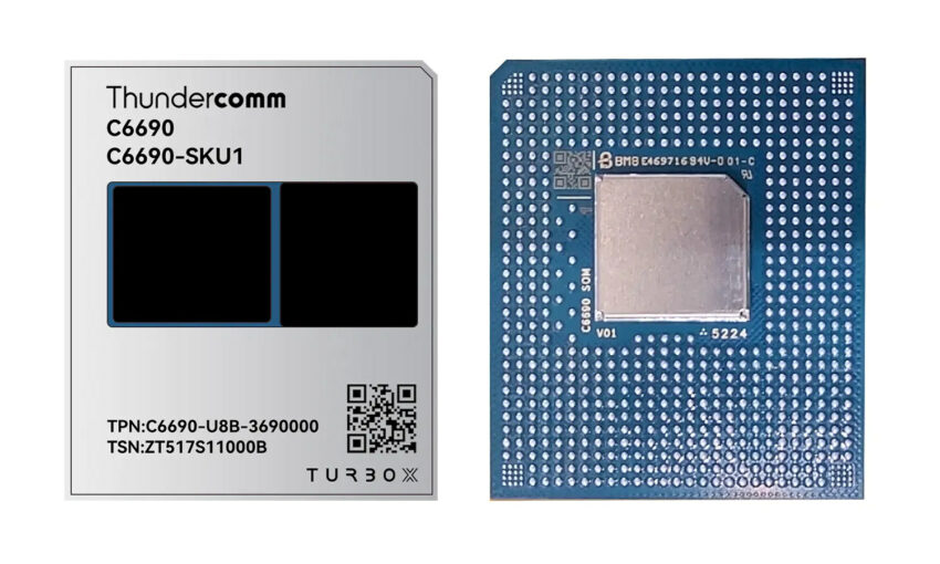

Thundercomm, established in 2016 as a joint venture between Thundersoft and Qualcomm, specializes in advanced technologies such as AI, IoT, 5G, and cloud computing. The company recently introduced its latest system-on-module, the TurboX C6690. The compact module is built on the Qualcomm Dragonwing QCS6690 chip, which is manufactured using advanced 4nm process technology designed to enable rapid prototyping and deployment of advanced terminal equipment.
The TurboX C6690 module has a performance capability of up to 6 TOPS (tera operations per second) of AI computing power, powered by the Qualcomm Kryo 7-series CPU and Adreno 7-series GPU. This level of performance is ideal for on-device AI applications, enhancing processing efficiency and reducing latency. The SoM supports modular feature packages and provides substantial PCIe resources for peripheral expansion, including options for Wi-Fi and Bluetooth modules.
Specifications of Thundercomm TurboX C6690 SoM
  • SoC:
    • Qualcomm Dragonwing QCS6690 featuring
      • Qualcomm Kryo CPU 7-series with 1x Kryo Prime cores at 2.9 GHz, 3x Kryo Gold at 2.7 GHz, and 4x Kryo Silver at 2.0 GHz
      • Qualcomm Adreno GPU 7 series
      • Qualcomm Hexagon DSP with HVX and HMX Qualcomm Spectra ISP 665 image processing
  • Memory: LPDD4x 8GB and UFS2.x 256 GB, and uMCP
  • Video support:
    • Encoding: Up to 4K at 60 frames per second for H.264/H.265
    • Decoding: Up to 4K at 120 frames per second for H.264/HEVC and up to 4K at 30 frames per second for VP9
  • Display: 1x 4-lane MIPI DSI with WFHD+ at 144 frames per second
  • Camera: 4x 4-lane MIPI CSI D-PHY/C-PHY
  • Peripheral interfaces: 1x USB 3.1 with DP, 2x PCIe Gen3 with 1-lane and 2-lane, GPIOs, and QUPs (UART/I2C/SPI)
  • Power supply: 3.4V and 4.5V
  • Dimensions: 39x33x2.65 mm
  • Operating system support: Android 15
  • Operating temperature: -25 °C and +75 °C

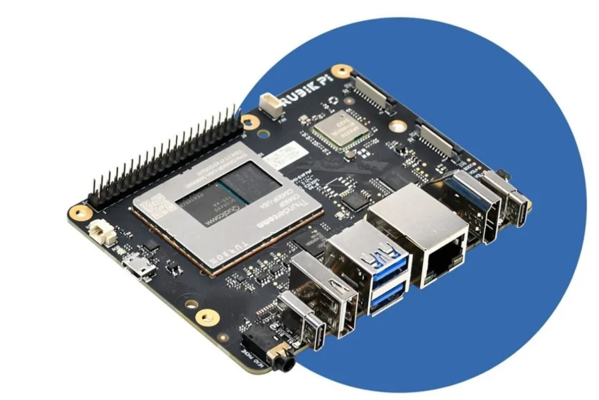

Thundercomm TurboX C6490 in Rubik 3 SBC (compatible with TurboX C6690)
Thundercomm TurboX C6490 in Rubik 3 SBC (compatible with TurboX C6690) [Source: CNX Software]
In particular, the TurboX C6690 module supports 4K video encoding at 60 frames per second and 4K video decoding at 120 frames per second. It also features four MIPI CSI interfaces for multi-camera data processing, suitable for applications such as smart displays and 4K video streaming.
The TurboX C6690 module is pin-to-pin compatible with other Thundercomm SoMs, including the TurboX C5430P, C6490P, and C8550. This allows scalability across various application scenarios, from low-end to high-end. In terms of the operating system, the module supports Android 15.
