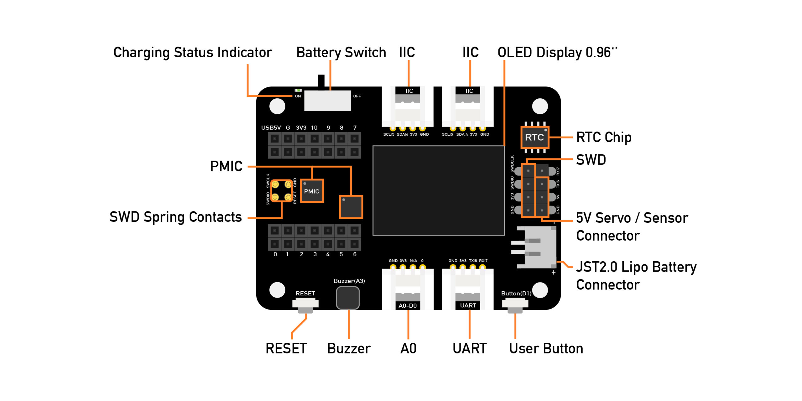

“Seeeduino XIAO Expansion Board is a powerful functional expansion board for Seeeduino XIAO of only half the Raspberry Pi 4 size,” says Seeed Studio. “It enables building prototypes and projects in an easy and quick way. With its rich peripherals, you could explore infinite possibilities of Seeeduino XIAO.”
The Seeeduino XIAO Expansion Board is a high-performance board that fulfills the needs of rapid prototyping and peripheral expansion. It has up to four convenient plug and play grove connectors that support multiple data protocols, an expandable memory slot that makes it possible to allocate more libraries needed in prototyping and project building, as well as a battery management system that supports both USB and lipo battery power supply, and an easy onboard battery recharge. The Seeeduino XIAO Expansion Board is compact and elegant in size and can be used for tiny and wearable projects.
Features and Specifications of the Seeeduino XIAO Expansion Board include:
  • Supports Circuit Python
  • Does not require soldering
  • 0.96″ OLED display panel (visual data to display without PC serial monitor; enables debug in a more efficient way)
  • A mini SD Card slot for storage (enough memory for adding libraries and using circuit python)
  • Passive buzzer
  • 5V servo connector
  • 1x Ready-to-use Reset button (no need for jumper wire and short circuit, reset easily with just one click)
  • 1x User button
  • 2x Grove I2C
  • 1x Grove UART
  • 1x A0/D0 Grove
  • JST2.0 connector
  • Single-wire debug (SWD) pin header (makes debugger connection and firmware download much easier)
  • High-precision PCF8563T/5 real-time clock (helps to maintain accurate time when the main power is turned off)
  • CR1220 RTC battery
  • Power supply: 5V / 3.7V Lithium Battery
  • Charging current: Maximum of 460mA
