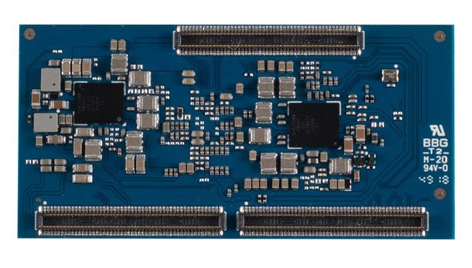

Open-Q 660 μSOM, back

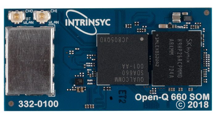

Open-Q 660 μSOM, front
