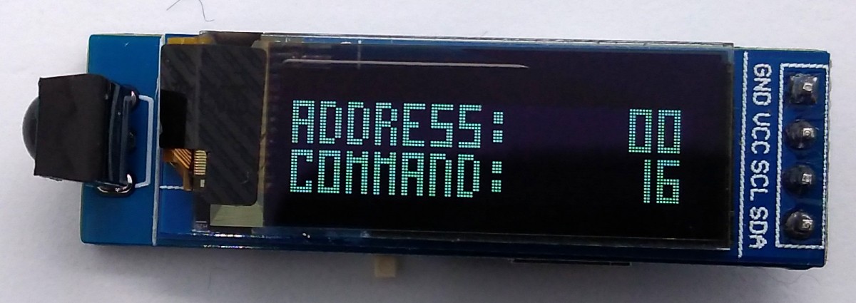

Now that you know how it works, let us have a look at the star of the show, the TinyDecoder. It consists of an IR remote receiver and decoder for the NEC protocol, using the ATtiny13A. On Wagiminator’s project (hosted on GitHub), which receives an IR signal via the TSOP4838 IR sensor, decodes the NEC protocol (including its extended version) and displays its address and command in an SSD1306 OLED display. It is powered by a small coin cell battery and everything about it is open-source, so you have access to the PCB files and the Arduino code. It can be a very useful tool if you intend to hack some devices.
The TinyDecoder in action
