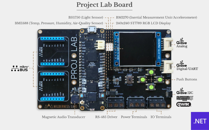

Wilderness Labs has launched a new hardware platform that supports various standard interface ecosystems, such as Seeed Studio Grove, Adafruit STEMMA, SparkFun Qwiic and MIKROE mikroBUS– Project Lab Board. This reference board is designed for its Meadow F7v2 Feather development board to enable faster time to market through rapid prototyping of IoT applications without having to do any breadboard circuitry and soldering.
Project Lab Board
Wilderness Labs has launched a new hardware platform that supports various standard interface ecosystems, such as Seeed Studio Grove, Adafruit STEMMA, SparkFun Qwiic and MIKROE mikroBUS– Project Lab Board. This reference board is designed for its Meadow F7v2 Feather development board to enable faster time to market through rapid prototyping of IoT applications without having to do any breadboard circuitry and soldering. Through onboard peripherals, the Project Lab board provides flexibility to interface with hundreds and thousands of external modules and sensors. The Project Lab hardware platform is packed with tons of integrated sensors and peripherals.
The Project Lab looks like a baseboard with a lot of interfaces and onboard sensors, with some of the sensors, including BMI270 accelerometer/inertial measurement unit, BME688 temperature/pressure/humidity/air quality index sensor, and many more. The BMI270 is a state-of-the-art accelerometer that has been integrated into various embedded development boards to provide accelerometer functionality and has built-in gesture recognition. The second onboard sensor is the BME688 to offers best-in-class atmospheric data, including gas and air quality.

Specifications of the Project Lab board:
  • Module: Meadow F7v2 Feather Development Board
    • MCU: STM32F7 microcontroller
    • Wireless connectivity: Wi-Fi and Bluetooth Low Energy
    • Memory: 32MB RAM
    • Storage: 64MB flash
    • Peripherals: GPIO, PWM, I2C, SPI, I2S, CAN, UART
    • Power supply: Integrated LiPo battery charger
  • Onboard sensors: BMI270 accelerometer, BME688 temperature/pressure/humidity/air quality index sensor, BH1750 light sensor
  • LCD screen: 1.54-inch LCD display with 240×240 pixels and directional pad buttons
  • Interfaces: Seeed Studio Grove, Adafruit STEMMA, SparkFun Qwiic and MIKROE mikroBUS
Project Lab Board Specs
The Project Lab carrier board fits the upgraded Meadow F7 development board designed for .NET programmers and witnessed a wide range of upgrades from its previous version. Some of the upgrades include 2x flash storage than in v1, an upgraded antenna to give 10x better performance, and a fully SMT-compatible to allow use as both a through-pole device and surface mount device. Other upgrades include the addition of I2S sound to enable both I2C microphone input and sound output. There also comes an upgraded power component, which is a fixed battery voltage to full 3V3.
