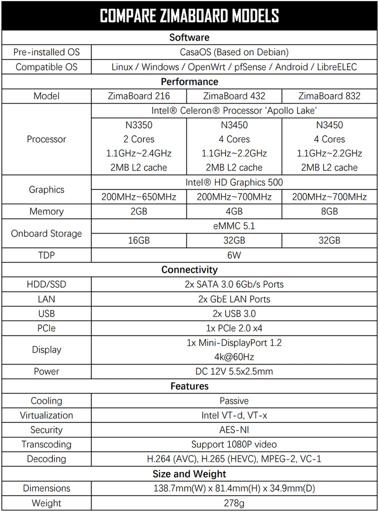

  • Model: ZimaBoard 216/432/832
  • CPU: Intel Celeron N3350 Dual Core 1.1-2.4GHz (216 Model), or Intel Celeron N3450 Quad Core 1.1-2.2GHz (432 & 832 Model)
  • RAM: 2G/4G/8G LPDDR4
  • Onboard Storage: 16GB/32GB eMMC
  • HDD/SSD: 2x SATA 6.0 Gb/s Ports
  • LAN: 2x GbE LAN Ports
  • USB: 2x USB 3.0
  • PCle: 1x PCle 2.0 4x
  • Display: 1x Mini-DisplayPort 1.2 4k@60Hz
  • TDP: 6W
  • Dimensions: (W x D x H) 138.7 x 81.4 x 34.9 mm
  • Weight: 278g
  • Other Feature: Passive Cooling
    • Intel VT-d, VT-x, AES-NI
    • Support 4K video transcoding
    • H.264 (AVC), H.265 (HEVC), MPEG-2, VC-1
  • Pre-installed OS: CasaOS (Based on Debian)
  • Compatible OS: Linux / Windows / OpenWrt / pfSense / Andorid / Libreelec

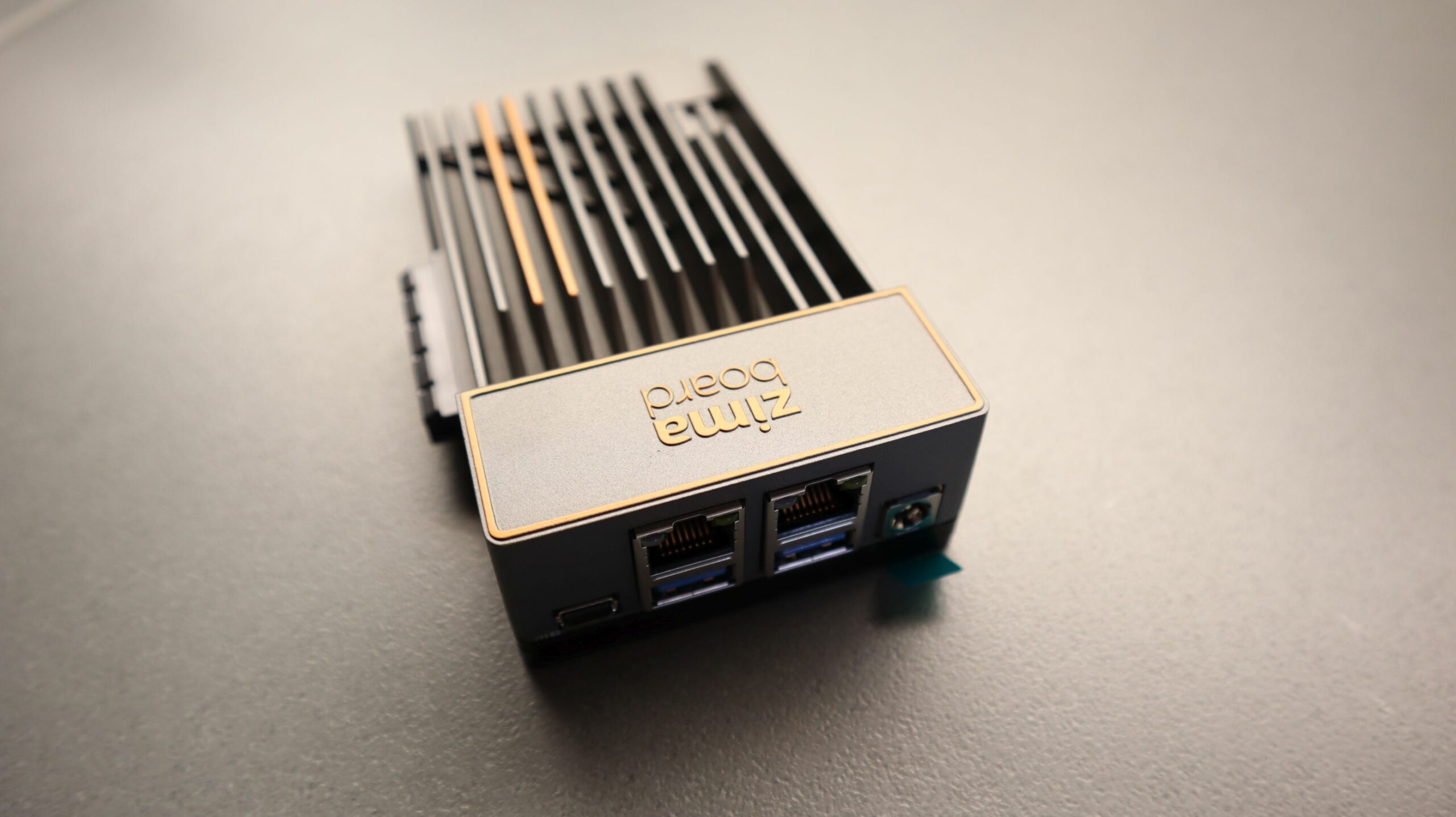

Whether you need to set up your VPN, access files remotely, or simply stream media, having Ethernet ports is essential. It offers 2 x Ethernet ports for network connectivity which may be more than enough for the average user. Additionally, it offers 1 x Mini-DisplayPort 1.2 4K @60Hz, which is another aspect that contributes to the “hackability” of the ZimaBoard. Instead of simply including a DVI, Thunderbolt, or HDMI port, they offer you the choice, emphasizing the DIY nature of the board, right? With a maximum compatibility of 4K @60Hz, the ZimaBoard is perfect for high-resolution media display. However, I wouldn’t recommend using it for gaming since you would typically prefer a refresh rate higher than 60Hz.
