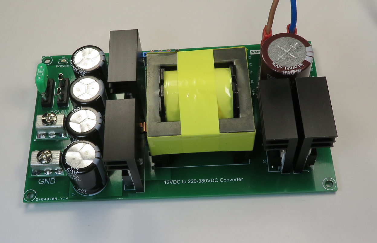

Ebay, AliExpress and other like stores have cheap 12VDC to 220-380VDC Converters (pictured above), ready for purchase under board names like QS-100 and GZF-02-Y.
These basic converter boards consist of a SG3525, four IRF3205 MOSFETs and a Transformer. They include no overload protection, output regulation/feedback or DC rectification. Nor do they include low voltage cutouts.
This project intends to build upon these boards and build in these other features and protection.
The converter uses a prewound 500W Transformer available from AliExpress.
This project requires a vertically mounted driver card – 12VDC to 220-380VDC Converter Driver Board (Closed Loop) or 12VDC to 220-380VDC Converter Driver Board – Open Loop.
